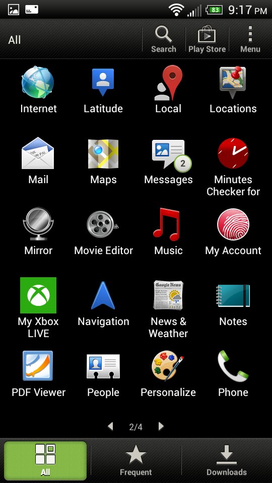

Here's some screen shots

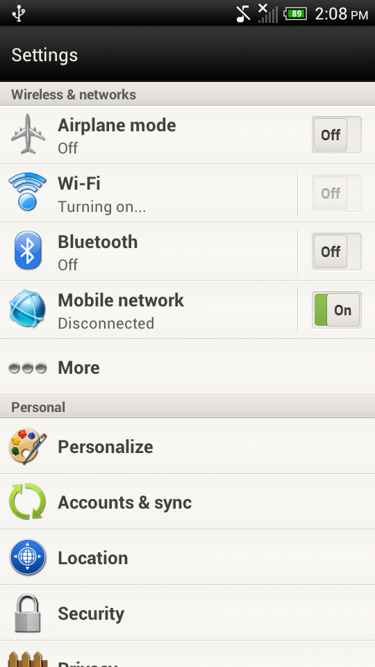

I've contacted VM and they said that there are no service outages in my area. What do I do now???? Even the stock vm shooter rom and my nandroid backup are not connecting. I've attached a screenshot. Says mobile network is on but disconnected. PLEASE HELP!!
Also Wi-Fi will not turn on anymore.
On the Fourth of July this happened to me also and i was sooooo scared. i also tried switching between roms that night but nothing helped. What eventually ended up happening was my phone dying from all of the shut downs and reboots. So what i did was take out the battery from my phone and left it out for about and hour or two. when i had gotten home aftter the hour or two i put the battery back in and charged my phone enough to turn on and everything was fine...weird. but that was my fix as werid as it sounds.
Gonna try my very first nandroid backup that I made when I first rooted my phone. If that doesn't work I will try your method. Thank you.
WiFi gets killed in deep sleep..follow my fix in op..as far as your 3g and updating your profile I have no idea bro..if it is from Rom to Rom the same issue I would say that its a virgin thing or something got jacked up when updating profile..I have never tried updating so I'm not sure
One more thing that you could do is open up the phone app an dial ##25327# and then the EPST menu should come up. Tap on you menu button and then tap reset and it should reactivate your phone meaning it will reconnect to VM.
