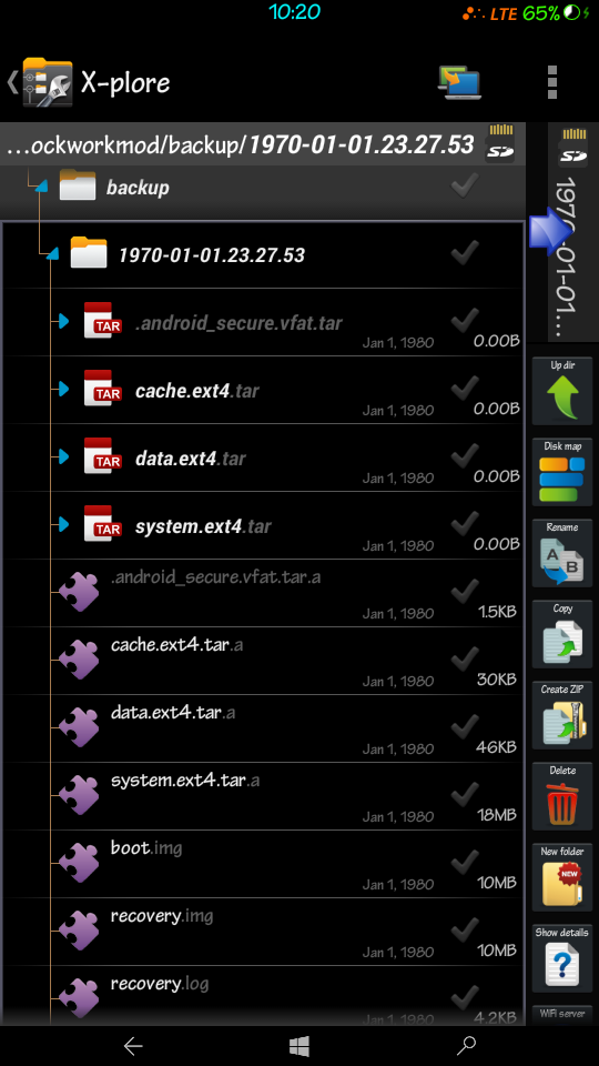

Hi everyone! I'm new here and I am very interested especially in the OT fierce 2 7040T because I got one here and it is bricked! it has already cwm chinese recovery and I wonder if it is stock or not! I can do backup in it (you can see it in the pic attached) All I need is if someone can help me how to unbrick it. It hangs in the boot screen Alcatel One touch fierce 2 powered by android!! I can access to the recovery fine but I really don't know what to do!
Sorry for my bad English!
Here is the attachment pic

I got one last thing: I ' ve tried changing the system.ext4.tar from @Dasman backup and the backup I've got in the chinese cwm! I also changed the nandroid.md5 of all the files to its appropriate and the restoration was successful but I don't know any way to restore the custpack.ext4.tar so my device doesn't boot, it only blinks after the bootlogo (it never happened before) so I concluded the restoration of the custpack is my last big challenge and I have no clue how to restore it!
You have to restore the custpack and the data folder. For some unusual reason alcaltel puts some of the app libraries in the data folder. The cm recovery isn't set to backup or load the custpack folder.

Well now...its amazing sometimes how much you can learn from a simple log file.
We need to see if you have adb access to the phone.
Do you have adb loaded on your computer?
Do you have a computer?
This is the second time I have seen something like this and I want to get the files off of your device.
I'll explain in a minuet.
Based on your boot image I would think you do have a Fierce 2.
Please pull the battery out and check the labels on the phone.
So heres what im talking about.......
ro.build.product=lenovoa860e
The recovery you are running is for the lenovoa Model: a860e
ro.boot.bootloader=L2C27070AW00 ( ---->>> mentioned earlier about matching the bootloader <<<-----)
This little bit of information is also a part of the command line that the BOOT.img contains.
I want to pull your boot image and see if you are in fact running lenovoa software.
ro.build.fingerprint=lenovo/cm_a860e/lenovoa860e:4.2.2/JDQ39E/eng.yitian.20130506.002150:eng/test-keys
This is the rom that the recovery is made for. The question is if this is the rom thats running on the phone. IT COULD BE.
ro.cm.version=10.1-20130505-UNOFFICIAL-a860e
This tells us that this is actually a CYANOGENMOD PORT.
Even though your phone is currently broken..........if it is running cyanogenmod.........maybe we can fix the cyanognmod rom on your phone. Then the rest of the community will benifit by having cyanogenmod to run on there phone.
Your recovery is Clockworks Mod Recovery.
It kinda sucks that you may have wiped out the original cyanogenmod files by trying to restore backups.
And thats why wifi is not working.
The wifi driver isnt loading.
I think your kinda lucky cause by now if you werent running cyanogen on the phone it most likly would be bricked by now.
