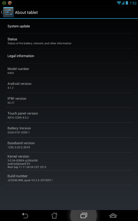

Hi i ve got fonepad 16g v3.2.5 can i still able to root and which is the correct link thay i need to install?
Dear Users,
let me know the method to root my ASUS Fonepad v3.2.5
I am from India (Delhi) which file should I select.
Thanks in advance
varun
