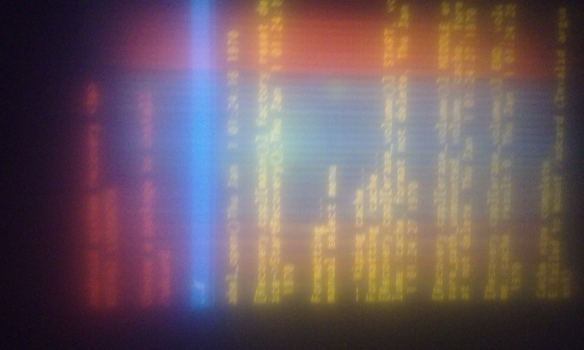

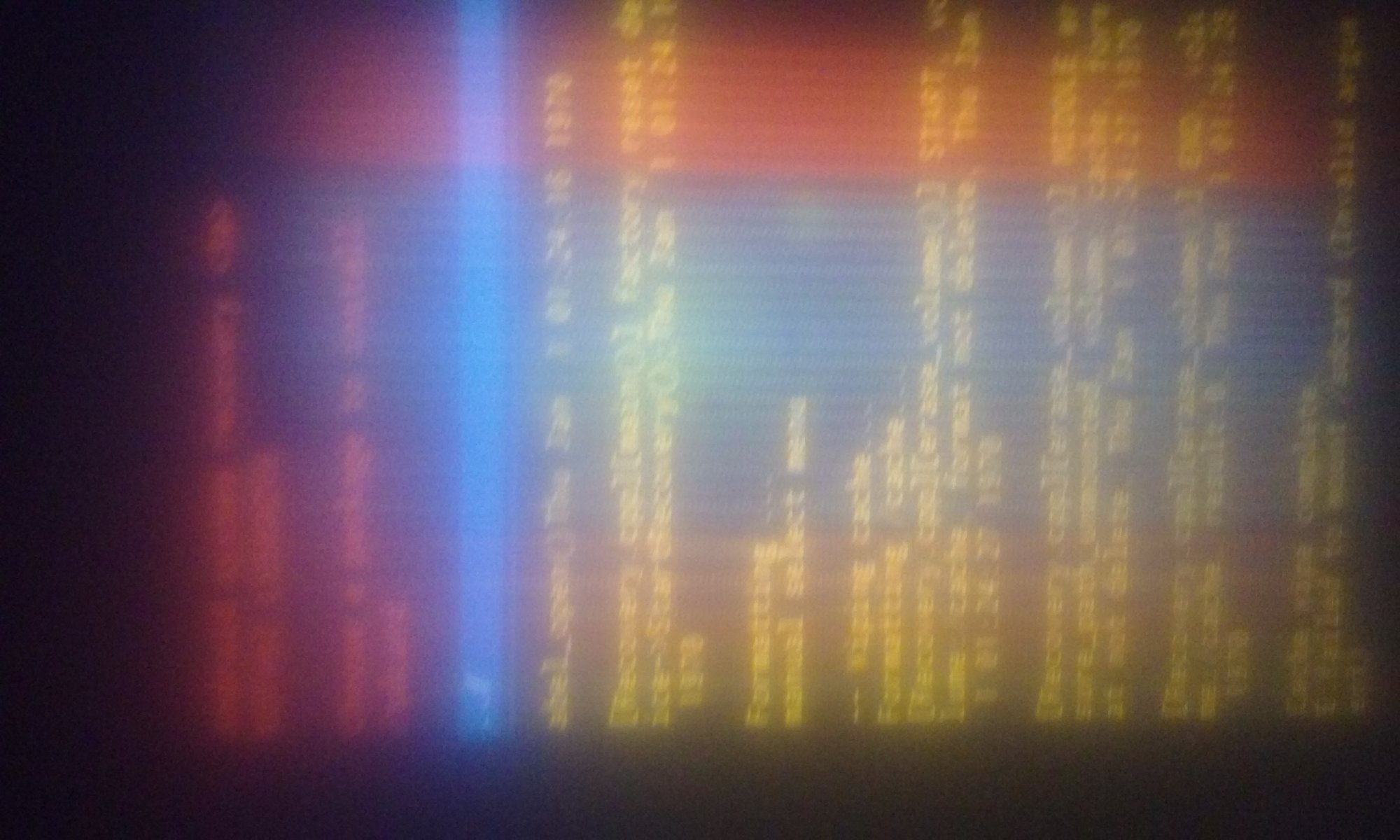

i must be a secret blonde or my phone is. i did just like you said i copied and paced the whole update zip file and my phone is still saying.... failed to mount... invalid argument
i really have no clue why i cant get this to work.. but im also get i different screen than the one you showed me
yeah im not able to type anything intoo that screen. infact i deleted everything off of the card and formatted the card then added the file
the phone formats everytime i boot to recovery everytime. then it says manual select menu then when i select apply from sdcard it says E:failed to mount/sdcard(invalid argument)
choose a package to install/sdcard
