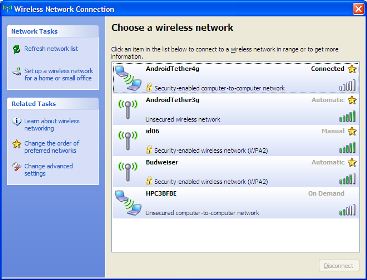

it was working but I changed apps and it stopped working. If you look at the WiFi connection window on the PC does it say it is PEER to PEER? On my ROOTED Nexus S 4g phone that I also have WiFi tether it works just fine and it uses a PEER to PEER connection just like it should. But with my 3G motorola it does not use PEER to PEER like it should be it says connected but not able to browse the web. Take a look at the screen shot I have. I think you should try the WiFi tether outside in the wild.
Doesn't say "Peer-to-Peer", it appears as a completely regular Wifi network. Like I said I have no idea if the Airave may be affecting it (that's connected to my router and modem).
