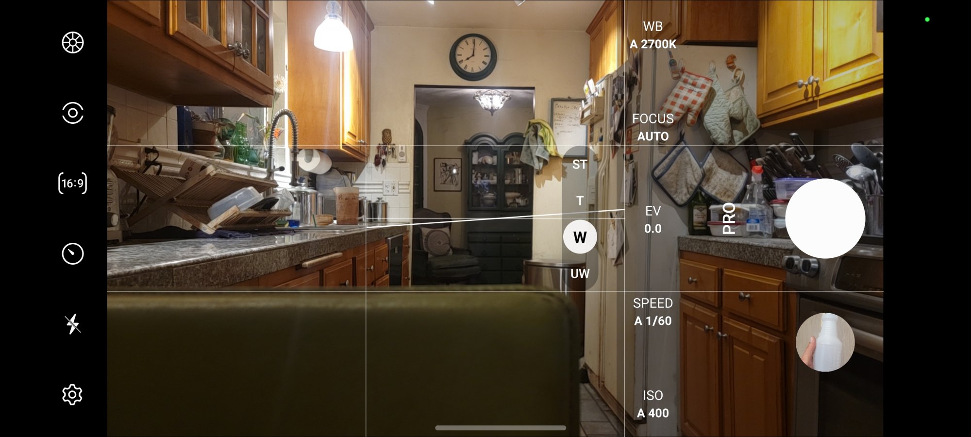

My S21 Ultra camera level is way off and there does not appear to be a way to calibrate it. When in pro video or pro photo mode with grid squares enabled, there is a horizontal line through the frame which is supposed to be a level indicator so you know the horizon will be level in the photo, but mine is off by a whopping almost 5 degrees and I cannot find any way to calibrate it. I have a separate level app as well as the level the s21 Ultra comes with and they are okay, but that is because they have a calibrate button within the apps that allows you to get it right. I want my level in the camera app to be correct, not WAY off. Can anyone help? Incidentally a google search for S21 Ultra camera level calibration produces no answers. Apparently, I have the only S21 ultra on earth with this problem. Please help if possible.

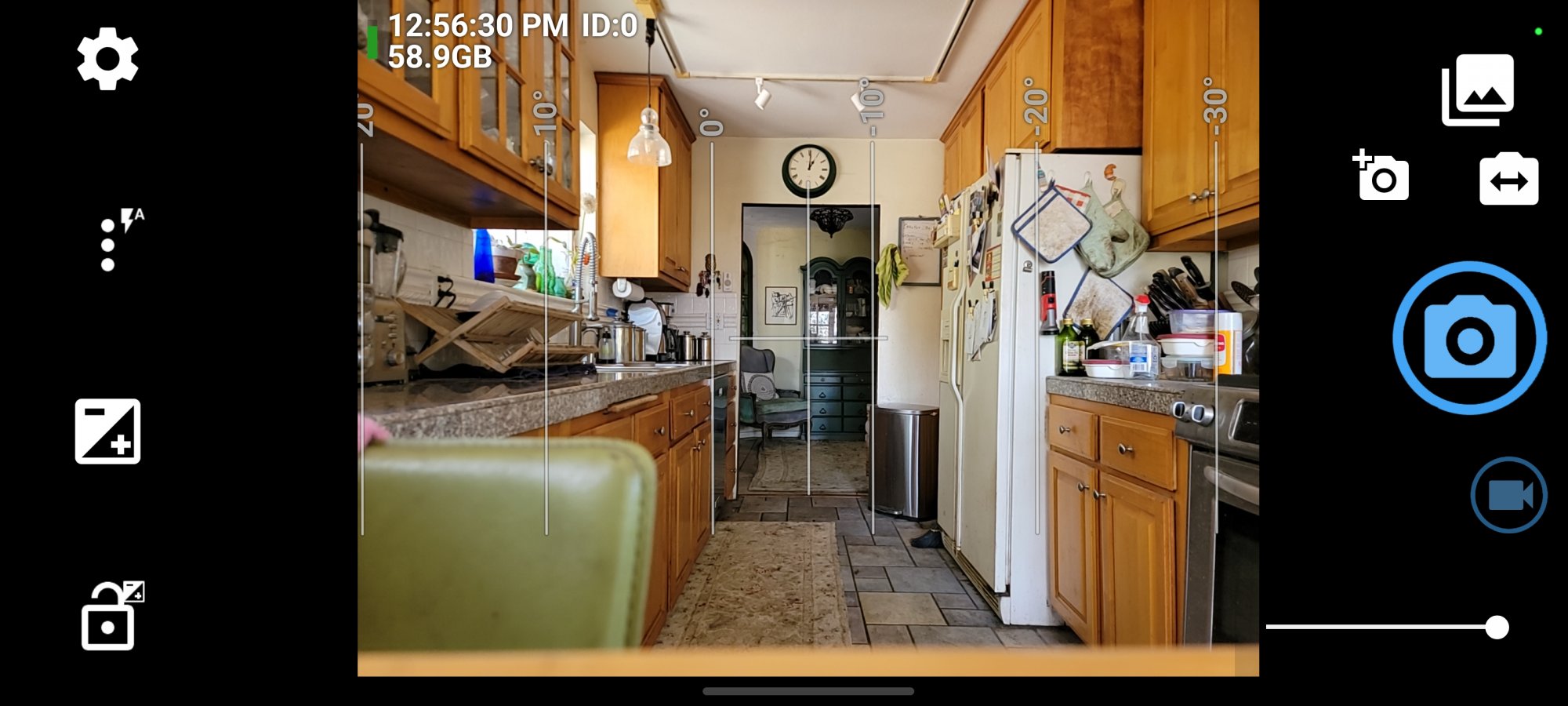

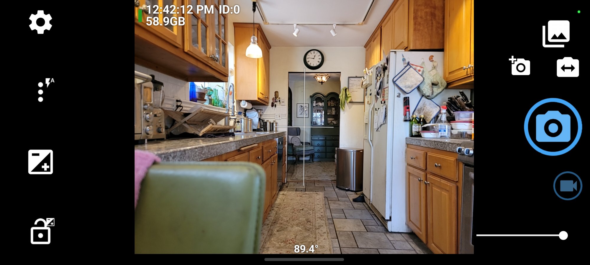

Thank you for the good suggestions. I tried the Open Camera app and it produced the exact incorrect level information. However, it has a level calibrate function which the Samsung camera app does not have. See the photos taken before and after calibration. I am thinking that there is a hardware problem with the sensor like maybe it is not positioned correctly within the camera body because it does report all axis information, it's just off by about 5 degrees. A calibrate button would be a big improvement, but if the problem is hardware, then it's only hiding the real problem. My warrantee expires in about 4 days. If I need to have a hardware repair, I need to make that decision very soon and I will need to backup and then factory reset the phone for security reasons before sending it in. What do you think?
