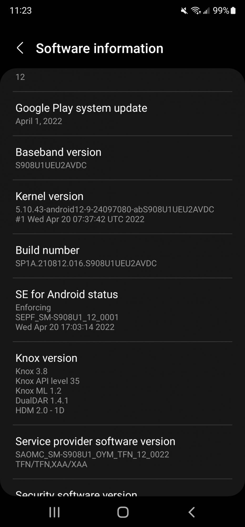

i just got an update to the s22 ultra just now. im on tmo and unlocked. what software version are you running on the phone?
screenshots of the app you are using is helpful to us since we cant see your phone.
your issues are with the carrier, not the device. the issues you post are not a behavior of a faulty phone.
This is a screenshot of the software version...
other than the google play store (yours is more up to date than my s22u) we have the same versions.
