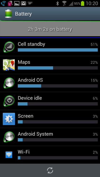

I keep seeing people state that the numbers add up to 100%.
You can see by my attachment that my total comes to 102. People have argued with me about this.
In my screen shot Maps is showing 22%. This would mean that Maps was running 22% of the 2h 3m 2s. Rounding off to 2h 3m means that Maps was running 27.06 minutes of the 2h 3m. If I am wrong just show me.
I believe the number you see for each app is what percent of the battery use was attributed to that app. Why they add up to more than 100 I don't know.
