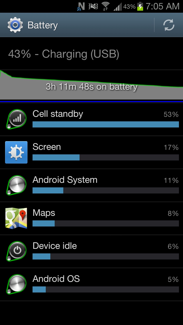

I had about a 70% battery drain overnight as well. However, I have sync disabled, mobile(4G) disabled, wifi enabled, auto rotate disabled, no mail accounts, only account I have is gmail, but doesn't sync, and I have no Samsung Accounts.
It's also weird because Maps app shows there, but I was asleep and the app wasn't even open? According to the settings, it's only suppose to update when plugged in? (Note I plugged in the charger prior to this, then sometime in the night the cable got unplugged, so it might of updated when it was charged.)
I am more concerned about the Android System. It seems to be a rare occurrence for the drain to happen so significantly, but I generally leave my phone charging overnight, so I can't be certain; I will try to leave my phone unplugged overnight more often to get more info. Anyone know what battery drain issues stem from Android System?
Maybe I should disable Samsung background processes anyways? Any suggestions?
EDIT: Uploaded pictures.
