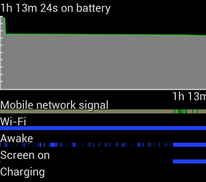

Hello everyone, I'm having an annoying issue with my S3 and I'm not sure if this is just a glitch that happens sometimes or if I'm inadvertently destroying phones somehow..
This is my second S3, the first was replaced after I had issues getting it to charge, upon investigation I was told it was corrosion and they replaced my phone.
My new S3 is about 2 months old and though it's charging perfectly, when I unplug the phone in the morning it will say 100% battery level, and then the level will instantly drop down to 60-70%.. Not gradually like it's being used up..

This does not seem normal. I would again discuss getting a replacement.
I agree that sounds like a bad battery, try using a different one before having the device replaced all together
You buy a new phone and you think someone should just buy another battery if the phone is discharging quickly? What is wrong with asking for a warranty on this battery. If it's the battery and I am also thinking yes it is the battery.;)
Nobody said to buy a new battery. We said to TRY a different battery. Take it back to where you bought it and see what they say. If it's new then yes they should cover it under warranty. Or if you know someone else with the same phone see if you can try their battery so you know what's wrong. Good luck!

Try powering down the phone to close all open apps. Then power up again and recharge to 100% and repeat your test.
Or, install your DH's battery in your phone and test.

Anyways, I deleted all the apps that I could which I knew were on both phones but not my husbands, and today is the second day in a row that the battery percentage has not plummeted and in the evening after a full days use I still have around 50% charge left (it wasn't lasting a full day before).
I highly recommend GSam Battery Monitor, as well as Wakelock Detector. Both were recommended to me through Android Forums and both helped me see which apps might have been causing excess battery drain. Hopefully the problem is really just as simple as an app that wasn't functioning properly.

It's a pain, but ATT will also probably suggest it, you can try a factory reset. I hate it when people tell me to do that because it's really a last resort, but if you're thinking of getting the phone replaced it might save you a few $$
I ran the phone completely dead, then charged it fully to 100%. Turned phone on and it said 50%. Left it on and it was dead in 2-3 hours. Put the battery in my daughters phone and it was at 79%. I called ATT yesterday and explained this to them. They are sending me another phone. They agree that its a phone problem and not a battery problem. Will see what happens when I get the phone. Hope to have it by Friday. Will update.
