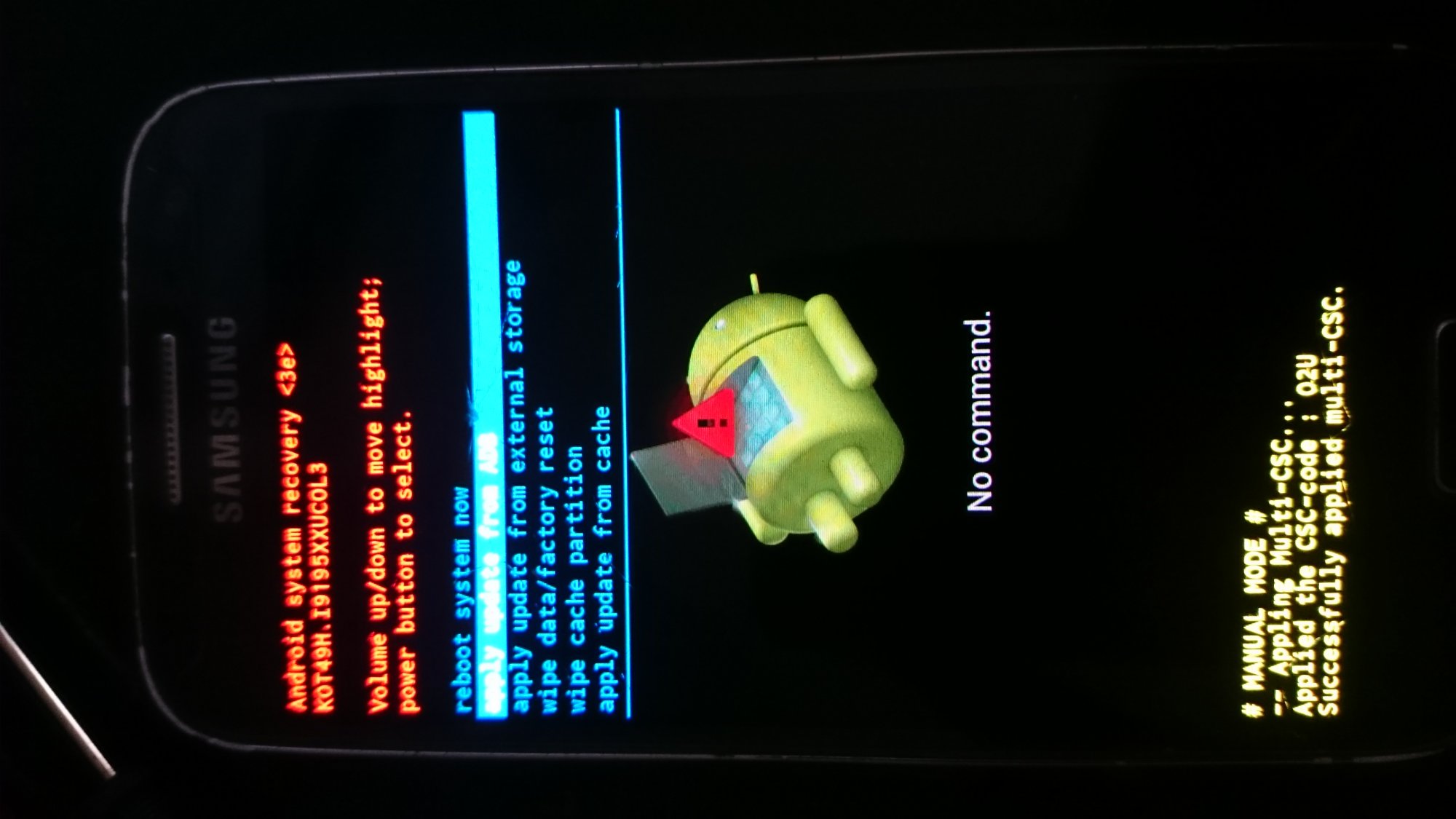

My son's s4 has gone 'loopy'. He said one minute it was fine, then not, and nothing happened as far as knows.. He assures me he hasn't got it wet, though he has been out riding in the rain with friends a couple of times lately.. :saddroid:
Anyway, these are the symptoms:
- Reluctant to turn off
- Will not boot beyond the 'Samsung Galaxy S4 mini GT-19195' logo screen (the first, plain, b&w one, not the later 'touchscreen' one..), hence:
- No touchscreen abilities at all, as it doesn't get that far
- Gets stuck on aforementioned Samsung splash screen, vibrating every couple of seconds or so.. :confused:
- Cannot be 'read' by PC, using a good, working lead
- Only thing I can get to is recovery screen (attached): it has been sitting quietly displaying that for over an hour
Battery charges up fine: tried another one (just by holding in place as it was from a Fame.. :rolleyes:) with same results.
Phone was bought used about a year ago (O2 network. UK: we use giffgaff) and has worked flawlessly, which is quite impressive considering today's young (and rough!) 'power users'! o_O
'wipe cache partition' reportedly succeeded, but no difference..
My next step is to try the 'apply update from ADB' but since phone and PC won't 'speak to each other'... :(
Having done a little research, I'm thinking the next step should be to open it up and check the power button.. kinda hoping someone will come along with some things to try so I don't need to do that..
(Have tried the 'slapping' method, repeatedly pressing the power button, etc..)
Hopefully there's enough info. in the attached pic., as I don't think I can provide more.. I assumed it was stock ROM but typed the 'KOT49H.....' # into google, and am thinking maybe it was rooted...?

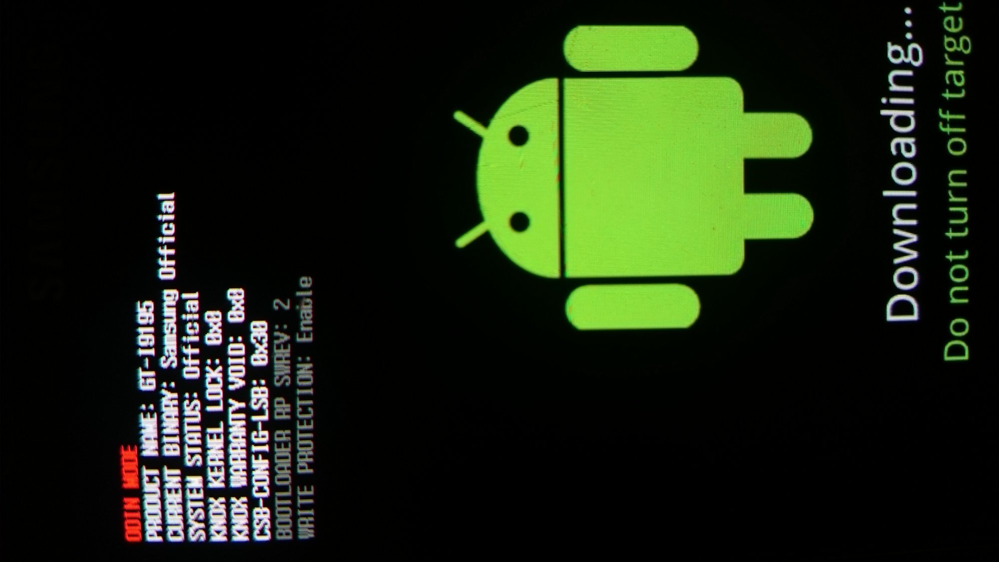

Have you tried download mode? power off, volume down, home and power at the same time?
Yes, but since it won't connect to PC it gets stuck.

At the bottom of the download page for the firmware in my first link is a link to download Odin 3.11
Once you install Odin in your PC, open it and connect your phone with it in download mode.
The pic you posted is download mode.
If Odin will connect to your phone you will get a blue box with a active Com port number.
Odin is the flash tool for Samsung devices used to install the stock firmware or custom recovery. Usually works best with the stock OEM Samsung USB cable that came with the device. Connect straight to PC and not a USB hub.
If connection is possible, download the stock firmware in the link and follow the instructions for flashing.
Nothing you can do with a SD card with stock recovery or download mode.

Ok, you got it to connect to Odin and was able to flash the stock firmware successfully? You got a green box in the upper left with "Pass"?
Phone did not automatically reboot after flash and still in download mode or did it reboot and still stuck on Samsung splash screen?
Yep, was successful :) green box, yep. 'Pass' yep :D
(Did it fairly quickly: I assume 04:59 under 'Pass' in Odin is how long it took)
No it didn't auto-boot. I selected reboot and it started dancing to its favourite Beach Boys track... (good vibrations) o_O

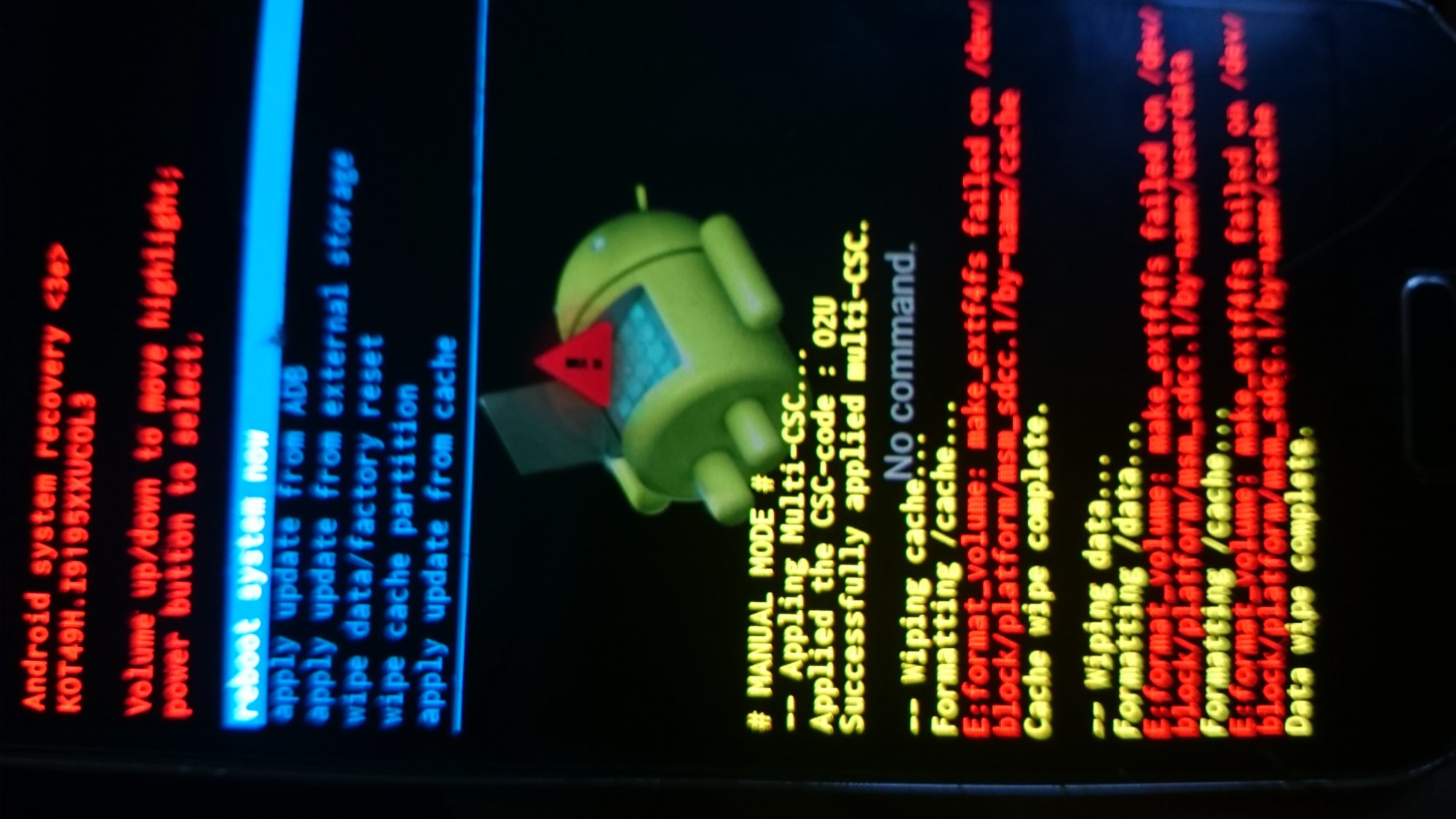

Used buttons to get to recovery mode. Wiped cache (again). Currently paused on factory reset screen, finger poised..
Hmm...
Flashing the firmware with Odin would have wiped the data so a factory reset would be the next step. Keeping my fingers crossed.
