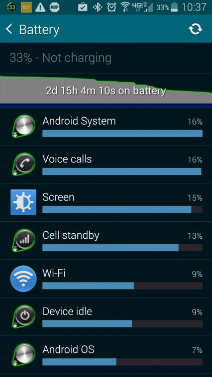

we can all argue how good, or bad, our batteries are, but it all comes down to how much juice we pull out of them.
me, I am sort of frugal, no social apps, no games, no interactive stuff, I get 3 plus days per charge.

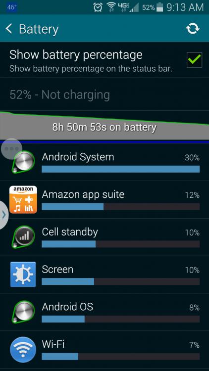

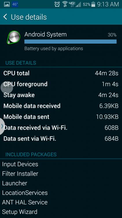

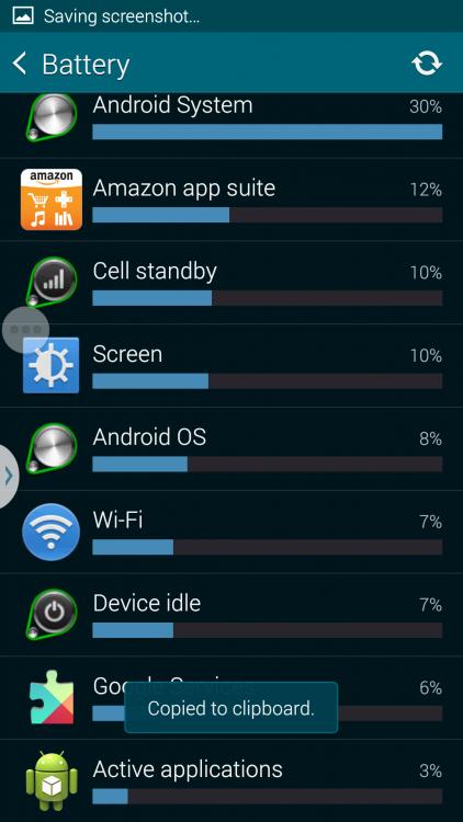

I just got my S5 8-9 days ago. The first 3-4 days I was able to go 20-24 hrs until getting below 10%, and I would only use about 10% while sleeping. Now, my battery has gone to crap in the past few days. After 12 hours I'm down to 30% - and that includes 6-7 hrs of sleep! Last night I had it on battery saver, and it STILL went down 30+% while sleeping!!!
Happened again last night. Woke up with only 52% left after only 8hr 50 mins. Around 8 hrs was when I was sleeping. It was at 90% when I went to bed, so I lost 35-40% while I was sleeping.
Any ideas on what's going on???

Just the stock strip it down until the problem goes away suggestions.
Turn OFF all apps you can't do without "right now", especially anything with 'Amazon' in the name.
S Health runs continuously, so turn it OFF for sure.
Go to Google+ on the web with your PC and configure it to NOT sync, do NOT let it upload pictures (this will kill batteries), in fact, just disable Google+ until you resolve your problem.
Now, turn OFF both WiFi and Data and monitor the battery use. If you have the phone cleaned up, it should drop about 8-10 percent per day (24 hours). Well under 1% per hour for sure.
Social apps are horrible battery eaters, I don't use them on a cellphone.

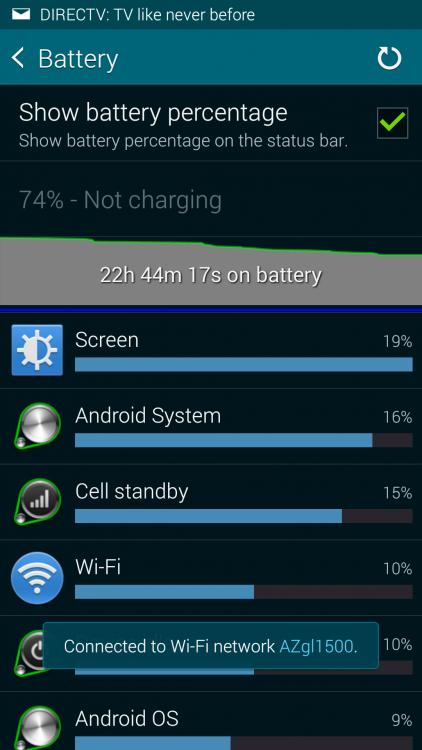

I personally, prefer to turn off the internet when the phone is locked and idle in my pocket. So, I use MacroDroid to run two macros.
Macro #1 senses screen status Locked, then it turns off WiFi and Data
Macro #2 senses screen status Unlocked, and it turns ON Wifi and Data.
When I unlock the phone, takes about 3-5 seconds total for the internet to come alive completely if at home.
4g locks on in about 1 second.
WiFi seems to vary but runs around 5 seconds after screen unlock.
Either way, it does not bother me for that short delay because my battery is always near full charge when I need the phone. That means I can do an awful lot of surfing, maps, navigation, ..... whatever, and the battery is still about 3/4 charged at the end of the day.

As u r a new user, you will need to turn off some settings as Azgl said. Turn off some unwanted motions and gestures. Disable auto brightness and set ur brightness to low as u can. Make sure u turn off ur wifi, mobile data, location and gps when not in use.
This should make some changes.

I had already 'Turned Off' some of the Verizon apps, but I turned off the rest of them yesterday. Seems to have worked. Only went down about 10% while sleeping, and was still around 20-30% after 22 hrs.
Great now that turning off all that stuff seemed to have fixed it.. Now you need to get to the root cause of the battery drain..
