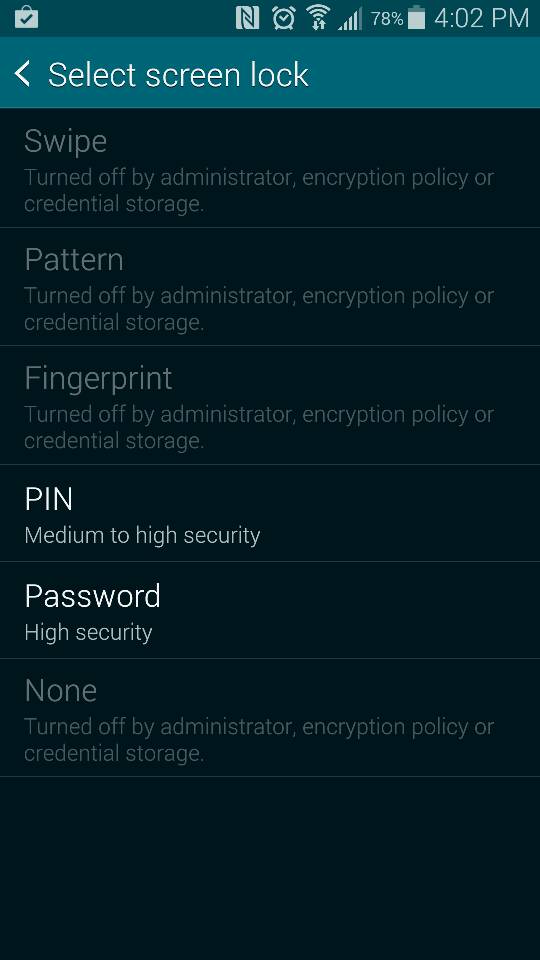

Also here is a screen shot of what I see when in fingerprint settings on phone. As you can see the fingerprint unlock is not an option for me. Is it for you?

Basically had to disable Exchange client access policy to not require a password. That did the trick. Funny how the iPhone 5s will use fingerprint as recognition when this is on but GS5 will not.
Exchange admin here. With the iPhone the fingerprint scanner just acts as a substitute for the PIN. With the S5 it is an alternate form of authentication. Every version of Exchange from 2003 on has had only 2 options for security. You can either require a PIN or a password. If as an admin you want to protect company data you have only these options. Hopefully Microsoft will add in the option to allow other forms, or Samsung sets up the fingerprint scanner to substitute for the PIN like the iPhone.

ive read thru all of the replies and I wanted to add this as well.
Android will automatically disable the ability to use biometric or pattern authentication when any of the following conditions apply:
- Native email client is configured to use an ActiveSync profile
- Any non-native certificates are installed (example: client certs, domain certs, user certs, root CA certs for a domain)
- Device or external media encryption is enabled
- Any program is storing credentials in the system Credential Storage cache
I was able to confirm this by manually enabling these features or installing applicable certificates on an Samsung Galaxy S5 which was not enrolled in a XenMobile environment. Unfortunately, enabling biometric recognition in XenMobile (or any MDM system) cannot override the authentication policy that Android has applied to itself as the more secure policy will always take precedence.
