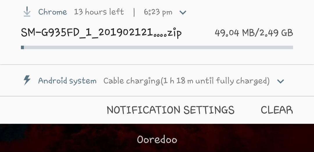

See it takes forever i think its because of the site where it is from or from the custom rom installed in my phone😑

Yeah i think its only the rom installed in my phone that causes the slow download. I tried using samsungtoolpro but i cant because i need to pay for something😫
Downloading to your phone could take a while.
No access to a wired or wifi connection to download directly to your PC?
I prefer donwloading from the phone then transfer to my laptop because if i use my laptop same thing and sometimes much worst the connection cuts without me even noticing it thats why i prefer from phone to my pc.
