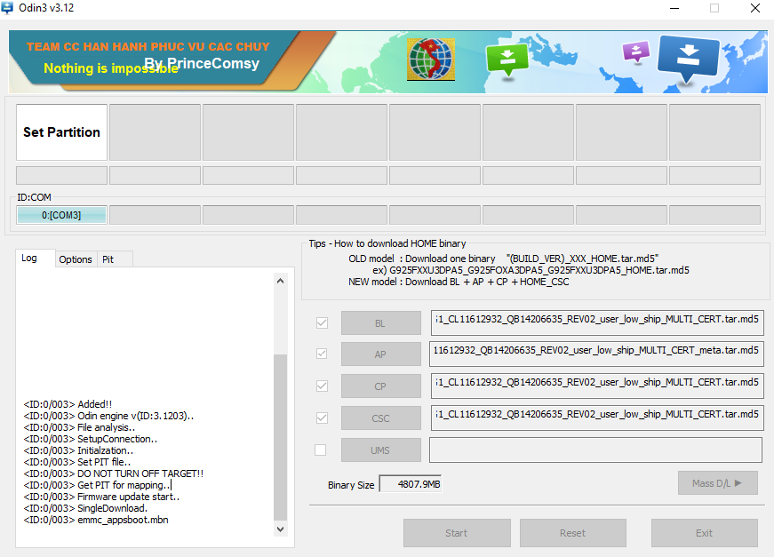

After loading all 4 files and connecting S7
<ID:0/003> Added!!
<ID:0/003> Odin engine v(ID:3.1203)..
<ID:0/003> File analysis..
<ID:0/003> SetupConnection..
<ID:0/003> Initialzation..
<ID:0/003> Set PIT file..
<ID:0/003> DO NOT TURN OFF TARGET!!
<ID:0/003> Get PIT for mapping..
<ID:0/003> Firmware update start..
<ID:0/003> SingleDownload.
<ID:0/003> emmc_appsboot.mbn
Seems stuck here? But it hasn't failed... at least the output is different.

Let it run till fail or success. Could take up to 30 min or more. I usually go make a sandwich or coffee.
Haven't seen that before. Can you post a screenshot?
I think it stopped...
Fingers-crossed this works out. I'm wondering if this is a USB issue, you don't have your phone plugged into a USB hub to you? Better to plug it directly into a USB port when doing something like this.
In any case, a ROM download is a 1GB+ file and it's being decompressed as it's being installed into your phone's internal storage so it's not a quick process.
Why are you using the modified Odin?....
That could be the issue. Or it's one of these, you're using a USB hub, USB 3.0 port or USB 3.0 cable. If you're using a desktop use the ports in the back. Last but not least any cable can cause issues, try one from a older phone or from a friend.
Use regular Odin 3.12.7 or whatever and you'll be fine.
Thanks for all the replies! I just woke up to that "set partition" in the top left tile of Odin and after unplugging the phone it failed. When I get home later I'll try Odin 3.12.7 & another cable if I can. Is there any way I can get the screen to turn off so it will charge better? Anyway, here's the Odin output:
<ID:0/003> Complete(Write) operation failed.
<OSM> All threads completed. (succeed 0 / failed 1)
<ID:0/003> Removed!!

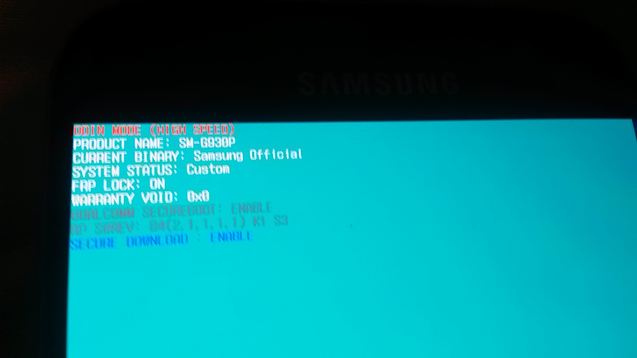

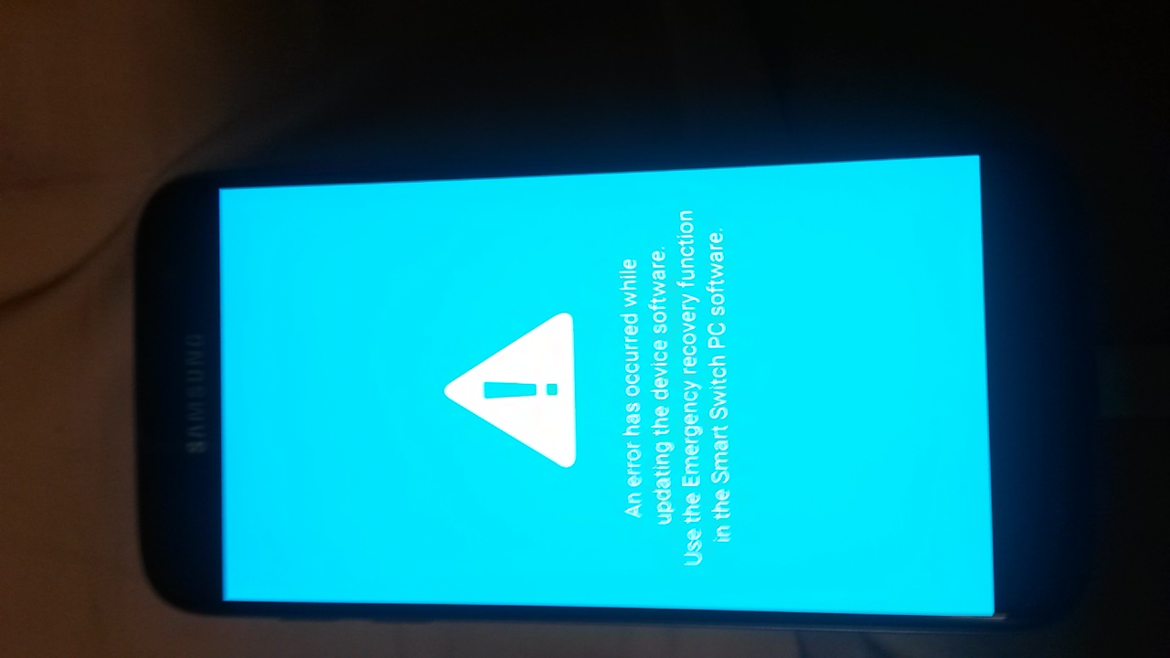

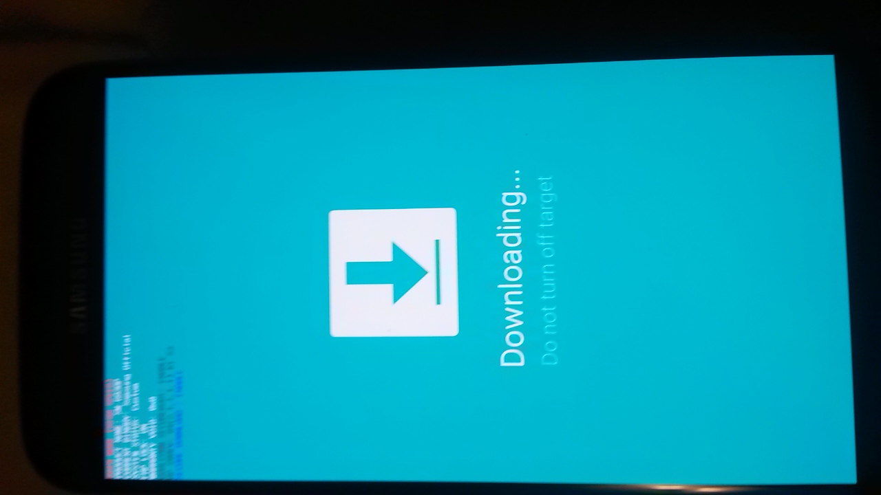

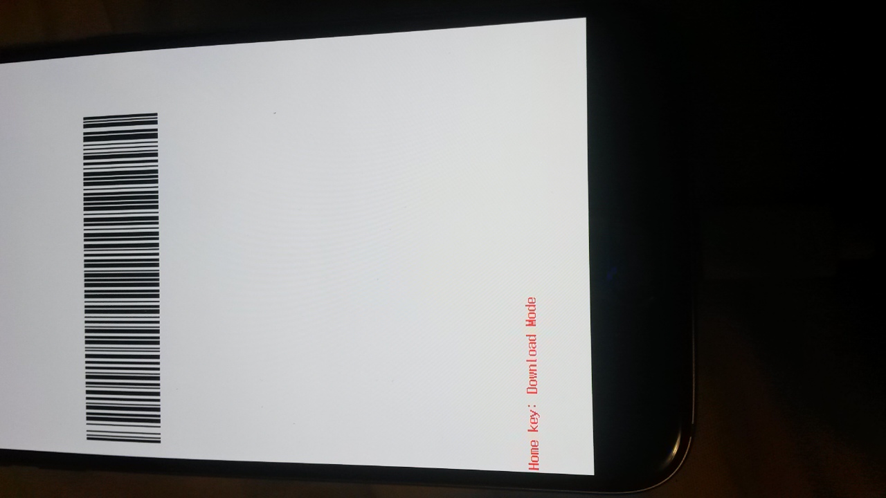

Just to be clear, besides bootloop approximately every 5 seconds, this is all the phone does:
