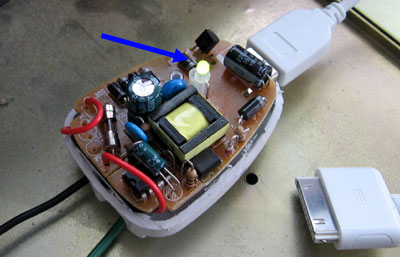

All USB chargers only have one step-down.
Which is that yellow and black square component, the step-down transformer.
This isn't a Samsung charger, but they all have similar looking components anyway, and only one transformer.
A serious problem with many cheapo chargers is safety, like it might catch fire or electrocute you, due to cheap substandard unsafe non-approved components. Or inadequate isolation clearance between the line high-voltage side and the secondary low-voltage side.
