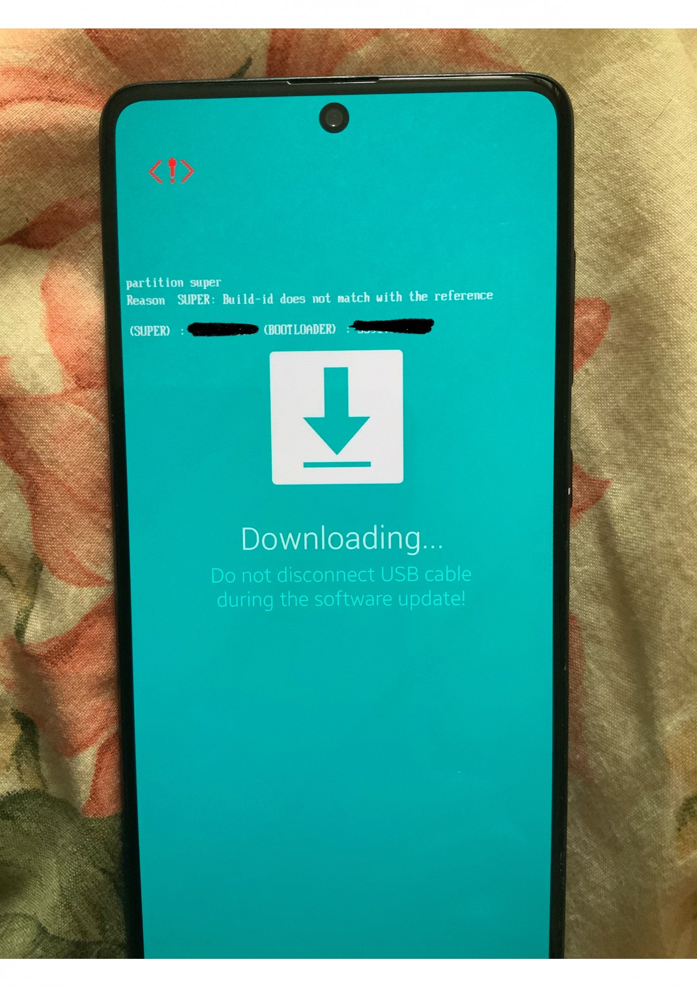

Samsung download crash blue screen
Someone PLEASE help me. I’ve tried calling 02 4 times and they will not help me.
I cannot access my o2.
If I hold the power button and volume, it shows the Samsung icon and then immediately returns to this screen. I don’t know what I have accidentally pressed.
Im worried I’ve lost everything.

samsung a71. When I press the buttons for 7 seconds it doesn’t do anything other than show the Samsung icon and go straight back to this screen.

ok you might need to reinstall its firmware dont worry as it will not clear you info like pictures and what not
this is to install the firmware
https://samsungodin.com/
this is the site you can get your firmware from
https://www.sammobile.com/samsung/galaxy-a71/firmware/
just make sure you choose the right one Im assuming you have the SM-A715F this process can take up to 10 to 20 mins but it should fix your problem
