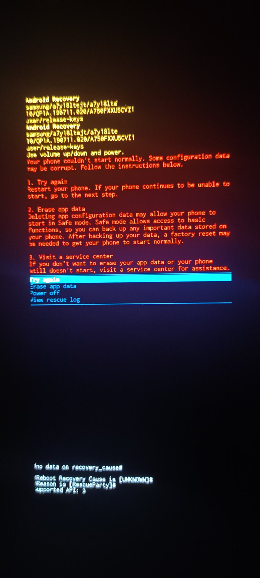

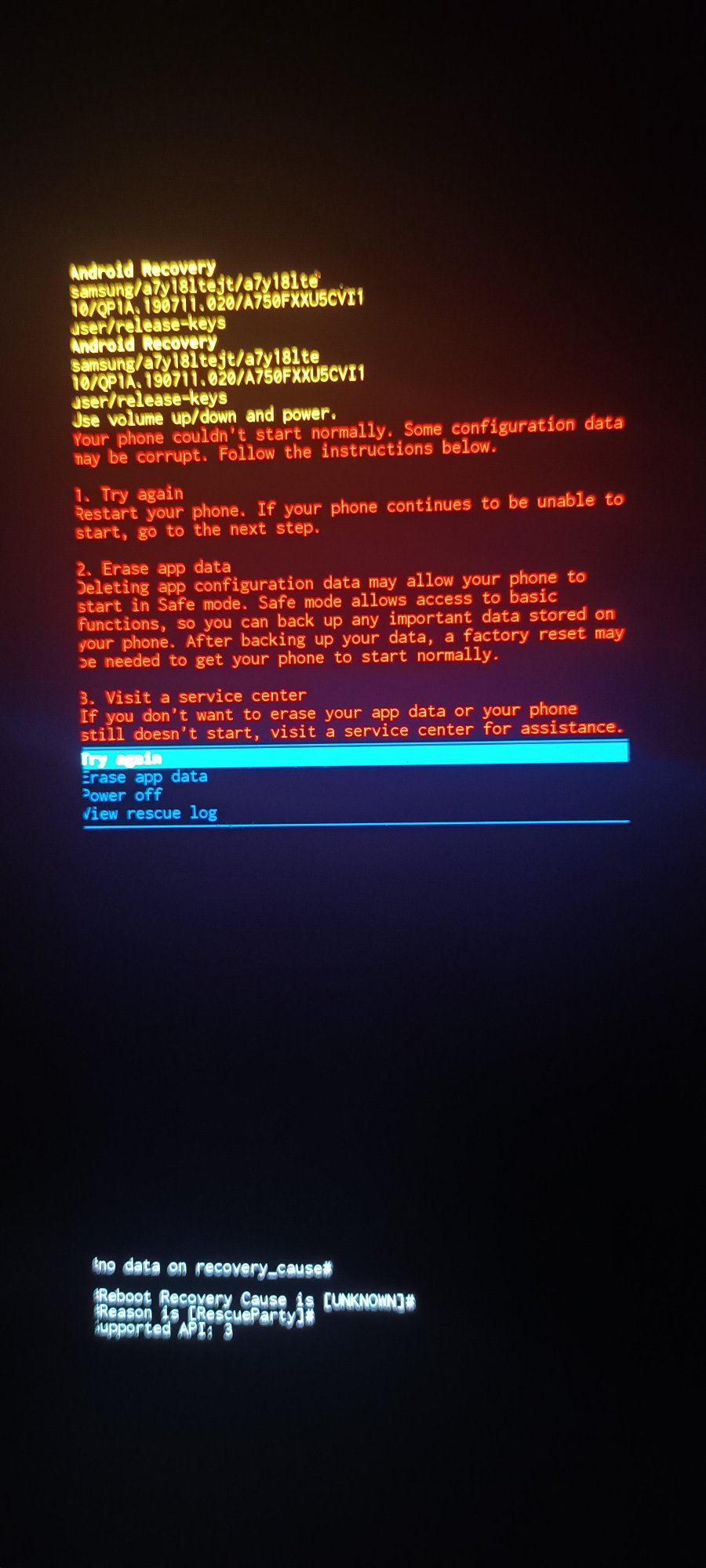

Today when I attempted to reboot my Samsung Galaxy A7(2018), the screen got stuck at Android Recovery. Now the technicians at the Samsung Support have advised for factory reset. The problem with factory reset/ wiping data is that I will lose all the important app data as well as other data stored in the internal memory of the phone. I want a way to exit the Android Recovery without losing all the data or want to somehow backup all the data before attempting a factory reset.
Please help!! Any help from the experts will be much appreciated.

there are partitions(sections) on your phone where it is separated into your android os and data. have you followed directions that is in your recovery mode? did you try the erase data function? it only deletes the app data configurations. this is not your app data. it should boot into safe mode. this prevents 3rd party apps from running. but you will have a working phone and most likely be able to backup your apps data among other things on your phone.
thank you. So should I go for "erase app data" option?
according to what recovery is saying....yes.
to be honest i have not seen a samsung recovery do that. but that is what recovery mode is for. if you selected erase data, it should boot up into safe mode, and you should have control over your phone and be able to backup or copy data on your phone.
Thanks. I'll give it a try definitely.

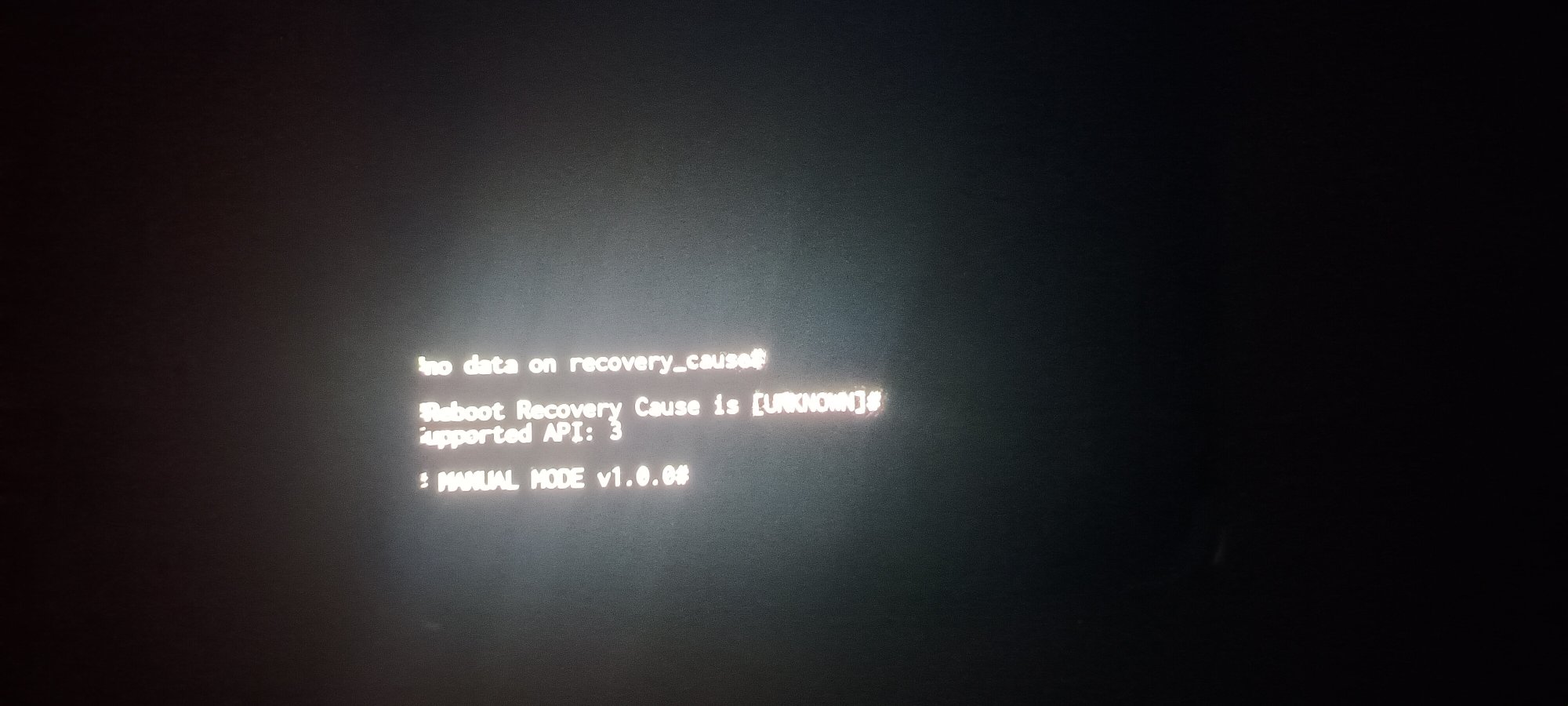

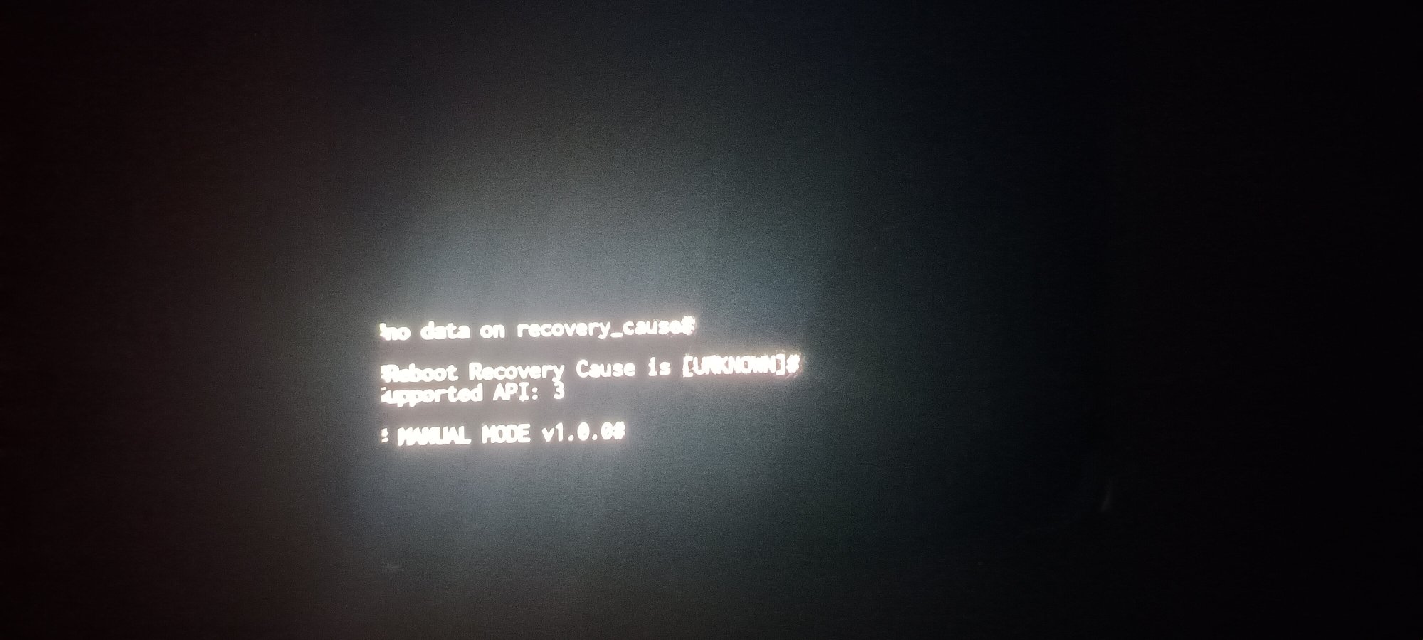

so this was after you performed the "erase app data" in recovery mode? can you explain in more detail exactly what you did to get this screen? did it ever get to safe mode?
I got to that screen by choosing the option "view rescue logs" from the second screen shot.
erase app data did not bring any change.

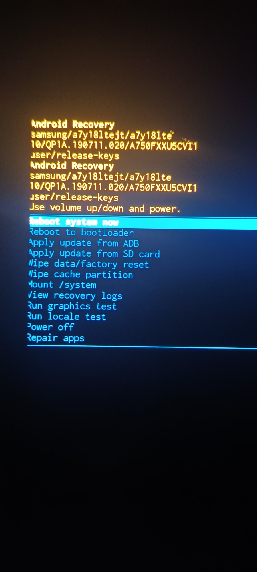

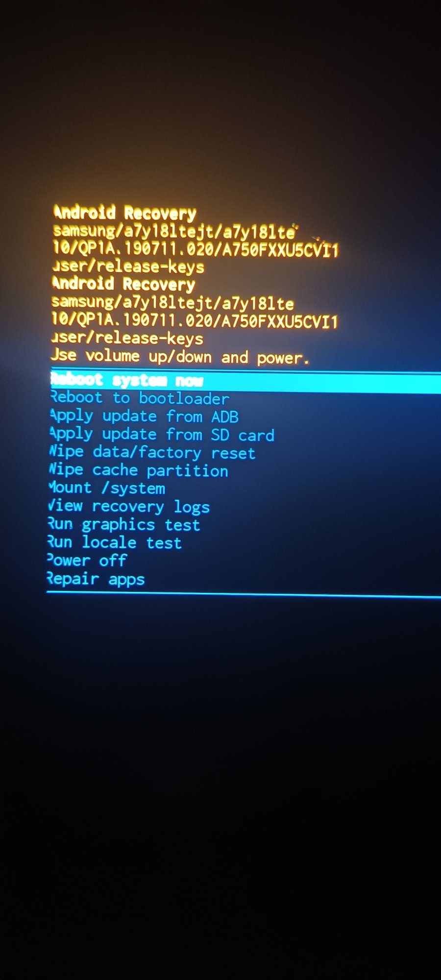

So the flashing process apparently worked out, no error messages. But since you're still stuck in a boot loop into Recovery Mode, than the problem doesn't appear to be an Android OS issue. That's good and bad -- the good part is there's still a good chance your data is still retained within the internal storage (if something like the chip failed, writing the new firmware would show errors). The bad part is still not being able to actually access that data.
I'm out of ideas on this, it's not a thing that's readily fixable via an online help forum. Hopefully someone else will chime in with suggestions but otherwise I'd suggest taking your phone to local, trusted phone service facility. This is likely to be more of a hands-on task.
yes the data appears to be intact. When I hit the "repair the apps" option from the Recovery Menu, it shows all the apps in the phone being optimized like it is done after an OTA update meaning thereby the internal storage is alright. It is just that the phone gets stuck in the Recovery Mode.
Try using that 'Wipe system cache' option in the Recovery menu, and see if that makes a difference.
I don't think it will fix this boot loop problem but it's at least trying. It will only take a few seconds to clear the system cache, and it won't affect any of your saved data and things. (Cache data are just temporary working files apps and services use and then discard.)
Don't be surprised if nothing happens when you select it though, starting with Android 10 or so Google has been dropping the system cache being stored within its own partition to be just a directory in one of the system partitions, and the change is being implemented gradually.
done wiping the cache but nothing happened.
