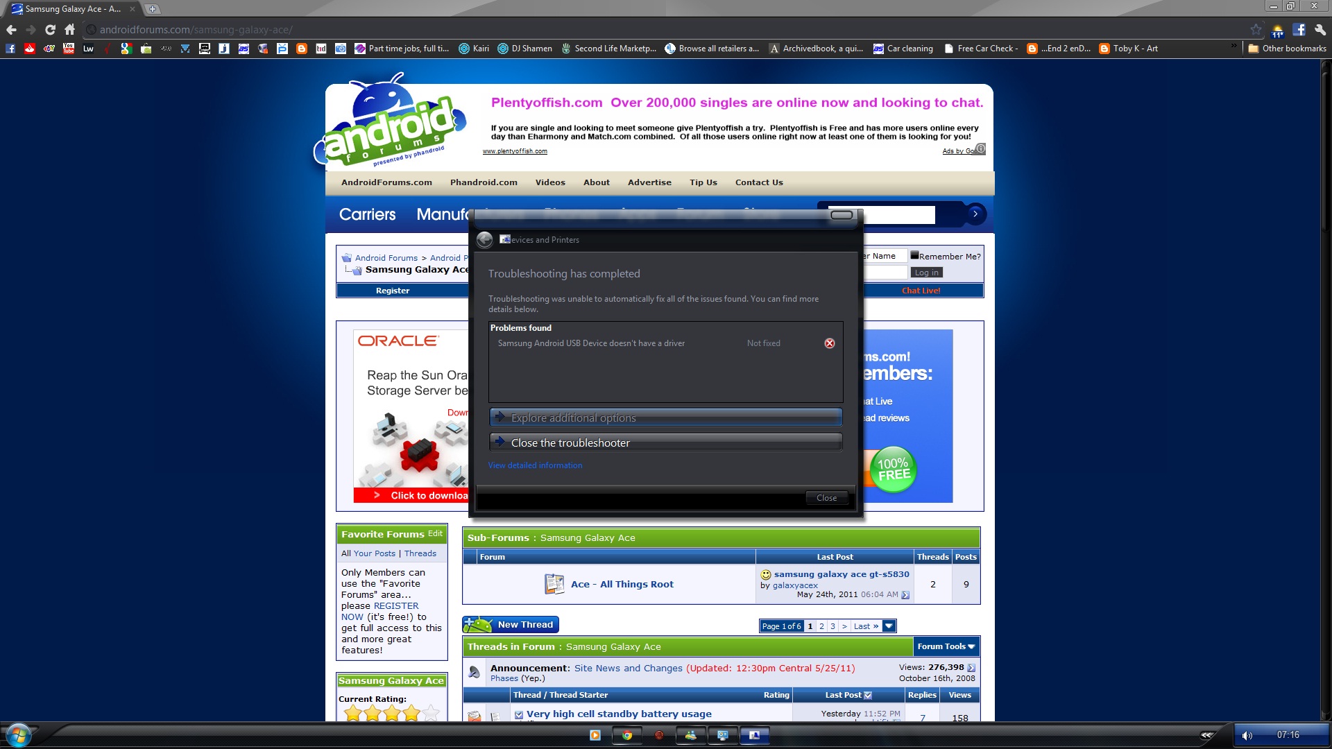

Ok so i've installed Kies on my windows 7 32bit laptop and pc. Now my laptop has no problems at all recognising my Ace and allows the usb connection with no problems, my pc however is just not picking my phone up.
I've uninstalled Kies and reinstalled a few times,i've updated it but still my pc will not pick up my Ace.
I get the driver installing prompt then device not installed. This is happening everytime i connect the usb cable to the phone. I know it's not a cable problem as it works fine on the laptop.
I've gone into device manager and uninstalled etc etc,i've gone into devices and printers and trouble shooted but still no joy.

This is what i'm coming up with after each attempt.

Ok so I solved my problem. I just copied the driver folder from Kies from my laptop to pc and it's worked.
Looks like for some reason when I was installing Kies on my pc it wasn't installing the drivers,although I tried severel times.
