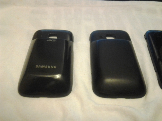

ok guys is easy for 6 dollars at any auto parts shop is JB KWIK weld cold and a little later imaginations try to put some more pictures to give you an idea but remember that you first have to buy the battery on ebay or amazon because this is the mold to set up the cold solder
I manufactured my own extended battery cover. Battery found it thanks to this forum as a member of the forum tube continue the idea and I went to a store and the Samsung galaxy veraizon continuing presence has the same battery but this phone if it produces the extended battery. pay as thirty dollars can not remember if ebay or amazon forgive my writing but I'm using the google translator
@heavyweightgd6, See my post "check this battery out-might be the answer". It shows that the extended battery for the Samsung Continuum will fit the Indulge.
@ersfrangel, That is made with JB weld? I am very impressed. Did you cut out a hole in a oem cover then build it up? Looks really smooth.
Yea it looks factory made! You can make a killing on ebay! I want 1!

I went to the metro pcs store and said he had lost the battery cover and gave it to me. I went after another look and said the same thing and gave me two more caps. That's what I did the first cover I am much wind but the second I'm much better
have you tested the cover with the larger battery? which battery specifically works? also, when are making some to sell? I want to get one asap so i can buy a larger battery. Keep us updated and im sure many people will buy it.

if you want you can help me in business and divide the profits. I'm just an auto mechanic with some ideas. all help is good and money better but really all this I do to solve the problems not solve metro pcs. to help this wonderful forum. if you can give me more imformacion what ploastico injection and I shall see how to do to get someone to manufacture the covers. not only for this phone for any android that has no extended battery if the battery made ​​with original cover extendido.recuerda I manufactured the different phones that have the same battery just that some others do not extend it
