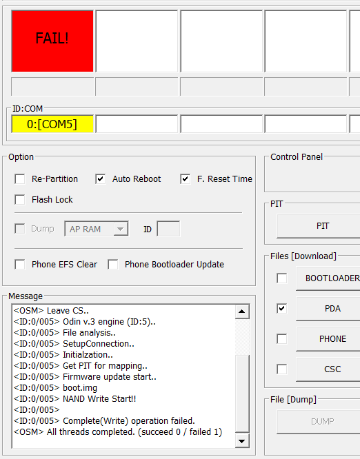

Ive got a "fail" now, what could it be.
It's been a while since I used ODIN, but it does recognize your device when you plug it in yes?
You should either disable, or remove KIES, (if installed) but leave the drivers. (ODIN and KIES don't play well together)
If you still are getting the failed messages, I'm not sure if some other drivers would help, or a different version of ODIN would help.
Hmm, I need a "scratch head" emoji here :p

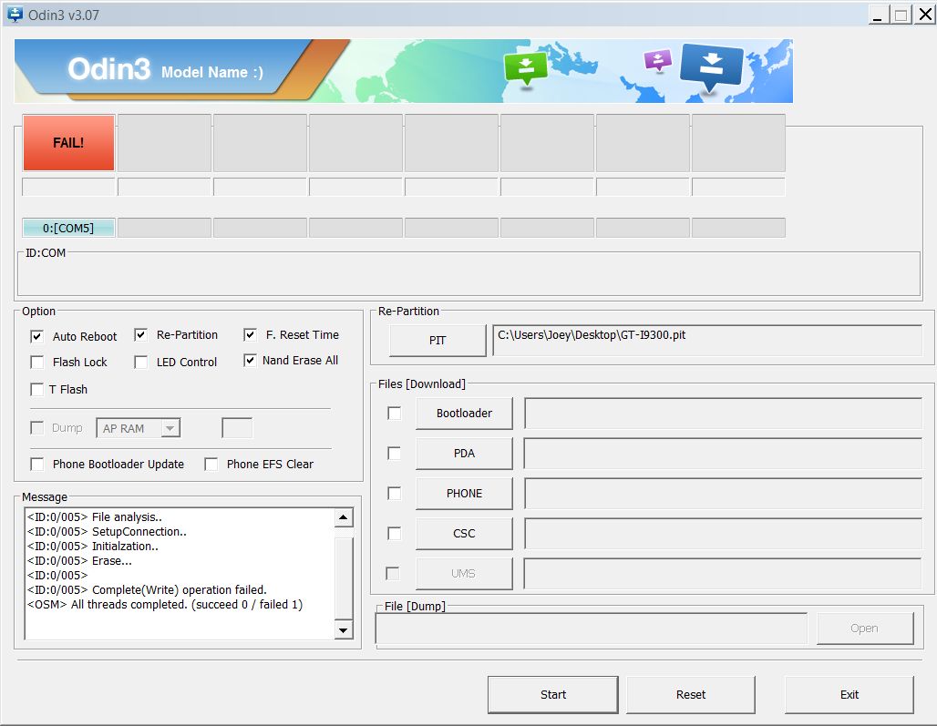

i really wanna try what the first link says but if a PIT flash goes wrong my phone will be dead forever right?
It not a big problem because a phone i cant use is useless also..
