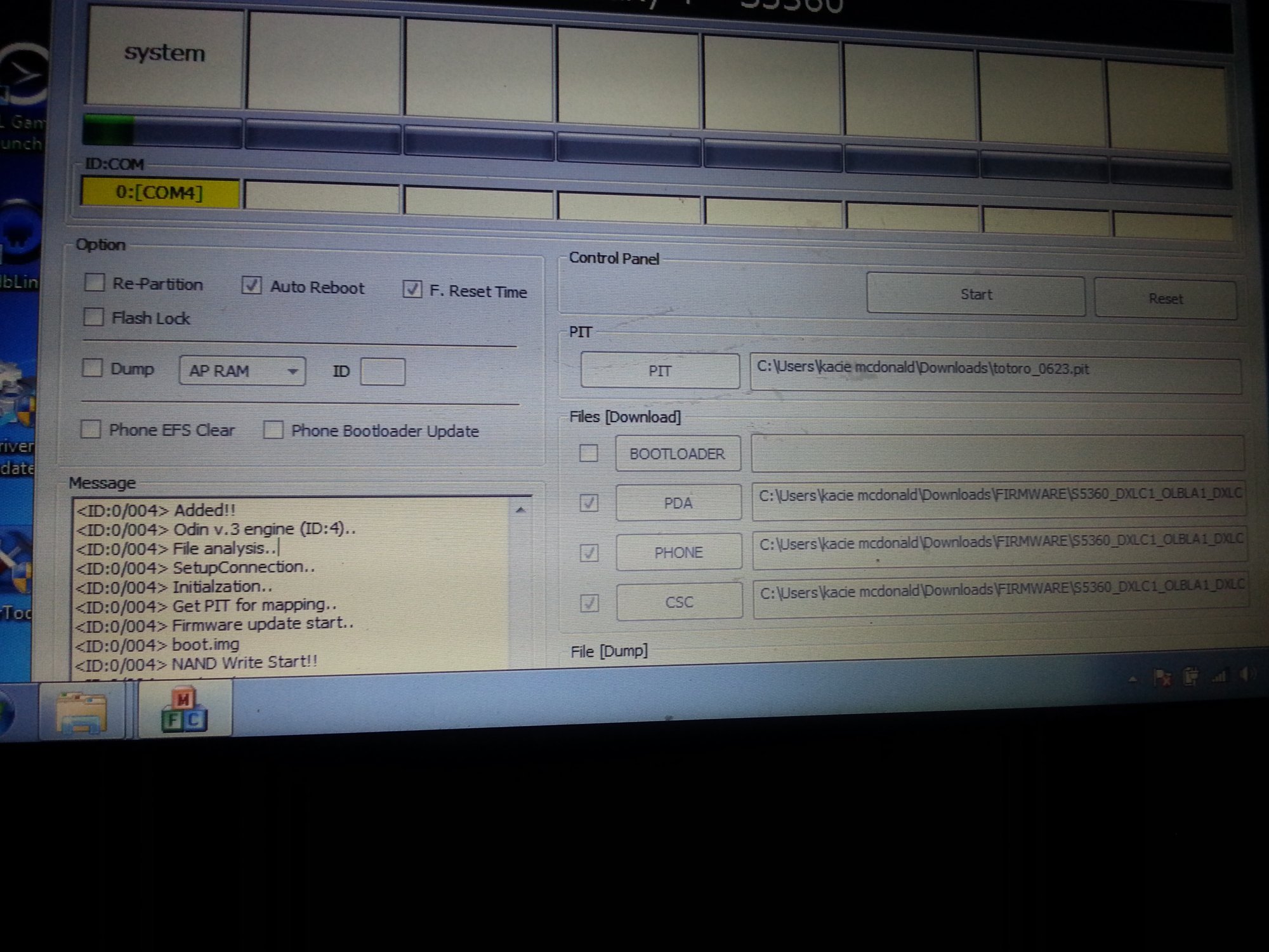

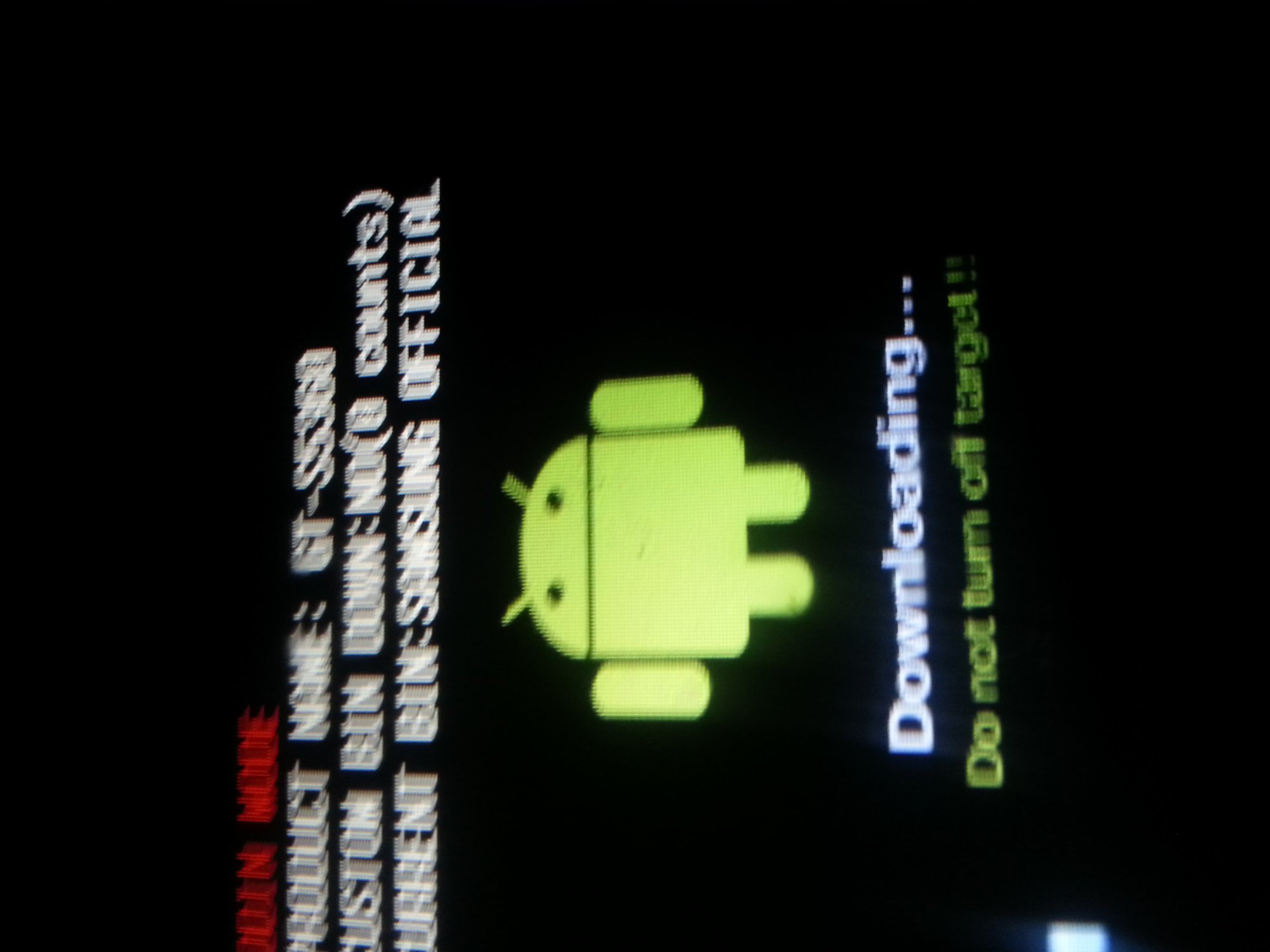

Please help I've been trying for days its on ginger bread so i tryed to put a difrent one on through odin but don't think I done it right so now I am tying to do this??? I've followed guides looked on so many forums but it's been doing that in this pic ages? Also now I can't get recovery to come up only odin but like I say that's just taken so long.....Please if anyone could help I'd be so grateful

I think first we need to determine exactly what you did. Could you point to the instructions you used to flash this device? And, where did you get the firmware? This phone is almost 7 years old, so you might not have to many options past gingerbread, which was the last official firmware for this device.
Not knowing where you obtained the ROM you're using I'm going to suggest you just re-download from here:
https://updato.com/firmware-archive-select-model?q=GT-S5360&exact=1
Pick the ROM that matches your locale and your carrier. Updato has a good reliability status for valid stock Samsung ROMs so it should be safe to use. It would have been more helpful if the screen capture of that Odin report was instead the the actual text result so whether or not the ROM even had anything to do with the problem, maybe just download from the source above.
Also, not knowing which version of Odin you're using (the ver. 3 in the screen cap wasn't very revealing), I also suggest downloading ver. 3_1.85, available here:
http://www.droidviews.com/download-odin-tool-for-samsung-galaxy-devices-all-versions/
The Odin utility is not very backwards compatible so newer versions may work out as well as just using an older version more appropriate for Gingerbread.

I tryed putting jelly blast on it didn't work just kept failing so I tryed to recover but trying to put it back to original 2 from dorks files on another forum. But now it's just booting over and over again and can't get to recovery now so......lol I've messed up big time ain't I?
Yea I can get into download mode....any chance someone can talk me through the whole process of sorting it out please also the right files as I been around the net past 4days and none of wht I'm doing seems to work
