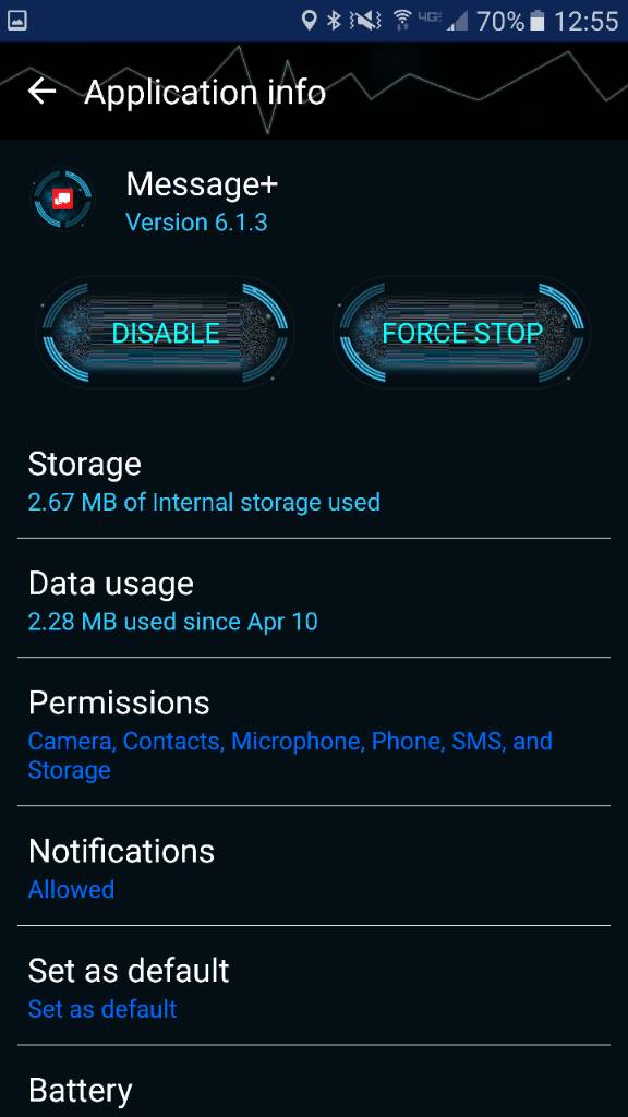

I was mistaken, I thought it was the 6.2.1 version that I was using. In fact it is the 6.1.3 version. I don't have any issues after uninstalling the 6.2.2 update. Still waiting on the 6.2.3 update.
