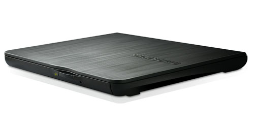

After months of nothing, I have finally ordered one of these from Germany. Well, it arrived today and I've had about 2 hours to play with it.
It is very slim and finished in brushed matt black. It has a single port (mini USB) and no power socket, nor VGA/HDMI output - probably too thin for that.
In order to work with Honeycomb, it has to be set to AV mode - eject the tray and hold the eject button for 3 seconds. Plugged into the TF201, it comes up with an extra icon (as it does for SD card) and you can then browse the contents of the inserted disk. Here's what I have tried so far:-
1) a home-made dual layer DVD - contains MOV files. Works fine.
2) a data CD containing a 'saved' website - works fine in Dolphin HD browser
3) an audio CD - works fine, but from file browser I can only manage one file at a time - most of the audio players don't let me navigate to the drive!
4) A commercial (film) DVD - tries to access the drive, but gives up. Tried the drive on Win7 and the film plays fine.

Ok, will do a side by side photo. I have just delved into the online manual which gives a better insight than the wretched quick start guide.... it seems that in AV mode, the drive won't read commercial DVD films! Maybe a firmware upgrade in due course (I have just checked firmware, and there is no upgrade yet).
