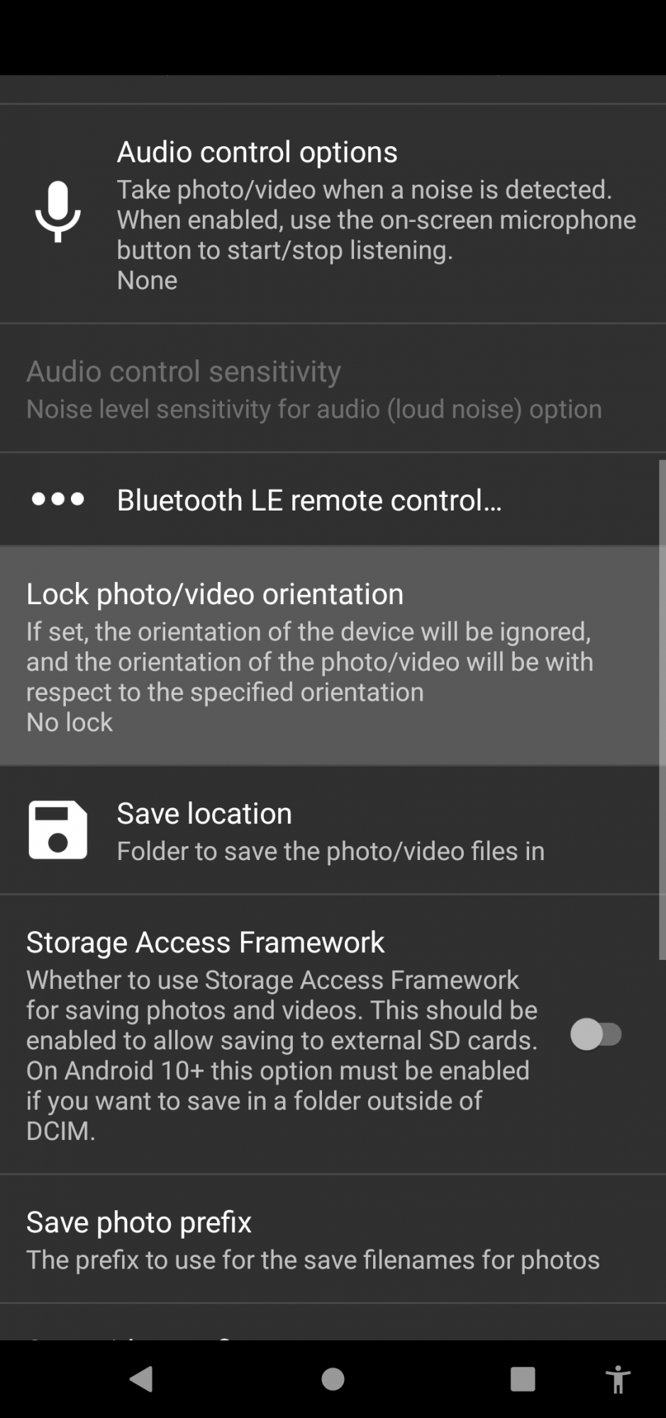

You are lucky!;) Check the OpenCamera settings to make sure that the option to save to the SD card is enabled and make sure that your SD card is properly inserted into the device and is not full.Restart your device and try again to save a picture using OpenCamera.Or you can try uninstalling and reinstalling the OpenCamera app.
Hmmm, that's odd. I have every other option that Danny mentions, except "Storage Access Framework". Maybe it doesn't show in the Q10, nor in my Moto G (1st gen).

Is your Moto G running Jelly Bean (4.3) or Lollipop (5.x)? If the former, SAF didn't come about until version 4.4. I don't have a clue regarding Blackberry OS 10 but given it's the same vintage as your Moto G 1st generation that might be why the SAF option isn't visible.

But getting back to why you're not able to redirect the default save folder, when you do try to use the Default save option, what kind of error message are you seeing? Also, are you attempting to use the same folder on your microSD card as what the default Camera app is using or a different folder?
I usually tend to move them into a much different folder and it is easy to transfer any images to a SD slot, if you do get Velocity Gallery that wich just said, and I know the ins and outs of Open Camera, I had it forever, as Danny said earlier, touch gear, and have his screen shot.
