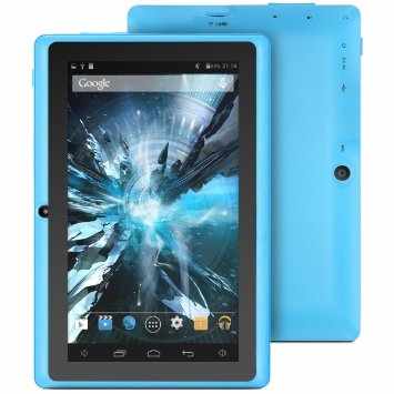

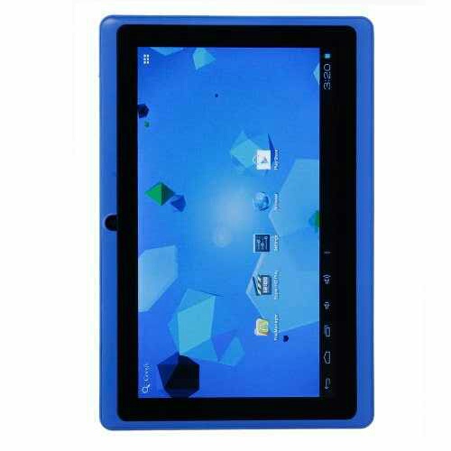

They were the wrong type,the way you described the off calibration sound like power serg,so looked into it and it seem allwinner doesn't list a model numbers to the device,they identify there devices by processor and then those last three numbers are in case it needs customer service,in example;your allwinner 7"inch tablet with processor A33 is giving to much power to the sensory screen made for the allwinner 7"inch tabet with processor A13,so when looking for an allwinner model 906is touch screen replacement its just gouing to give you allwinner 7" tablet all A# processor and the screens are exact in size and shape but take different currency of power given by the processor take a look=On top(Allwinner 7inch tablet Processor A33)and on bottom(Allwinner 7inch tablet Processor A13) As you can see they look almost identical but run at different processing.like mike dt brilliantly deducted from just the description of the problem,good call mike dt!in conclusion...your allwinner tablet is to powerful for that screen.sorry
