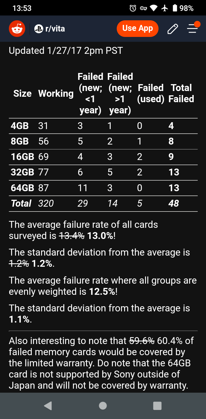

I found this during a time limited search on SD card failure rates.
Although this is from 2017, I can't see much improvement being possible- since my issues all occured from this timeframe onward.
Most recent for me was the complete failure of a 256GB card that had about 30GB on it and was about a month old.
This happened about a year ago, and since then I have refused to invest time, effort, or money in large capacity cards.
