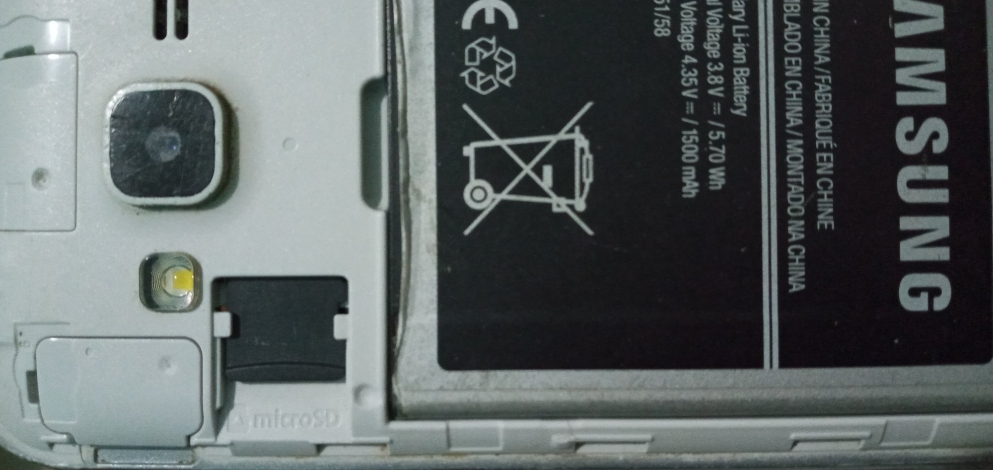

I had my Samsung J mini prime for few years and had almost no problems with it. Few days ago I noticed it was super hot so I opened the back and the part where the SD card is inserted was so hot I almost burned my finger. I never had anything like that happen before with any phone.
I turned off the phone right away n took out the SD card. Left it to rest for a day. So this is what happens. When I turn it on and there's no SD card in it it seems to be working just fine, the phone does not feel hot. The moment I put the SD card inside it becomes burning hot in that area. Also the SD card stopped reading.
I put another SD card in and it's working just fine. The contects of that SD card show up, and there's no problem with overheating.
I first thought this was my phone but now I don't know because it works fine with another SD card.
Could somebody help me figure out what is going on? Can I fix this? I have a lot of information on that SD card that I don't wanna lose.

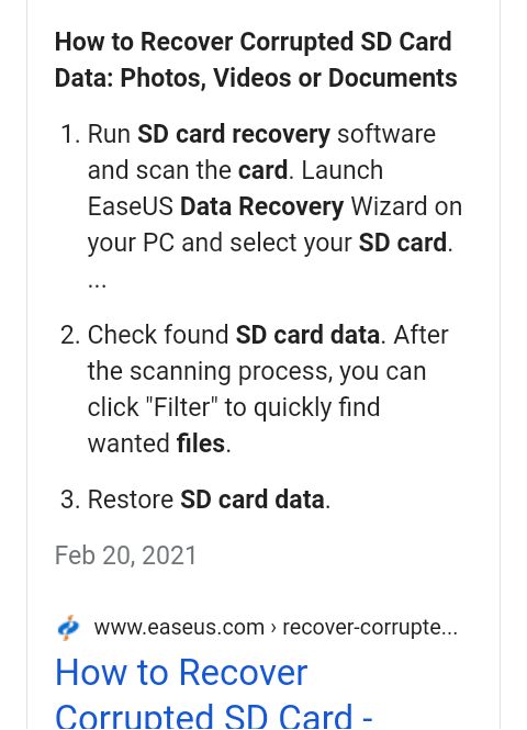

I keep finding information on the internet saying it's possible to recover data from damaged SD card
Can you log in to WhatsApp on the new device, and download the files to that device?
BTW, most of what you will find as far as file recovery from a SD card seems to be bunk.
Basically, when the card goes, it is catastrophic and the card is toast.
Any microSD card is just inert storage media. There's no spinning disk involved that requires a motor and power for that motor, nor is there even any mechanism that will generate its own heat source. The heat you felt was mostly just transferred from some component in the phone itself, up through that card. Blaming the card for that heat issue is misleading you from looking into the actual problem and its source.
