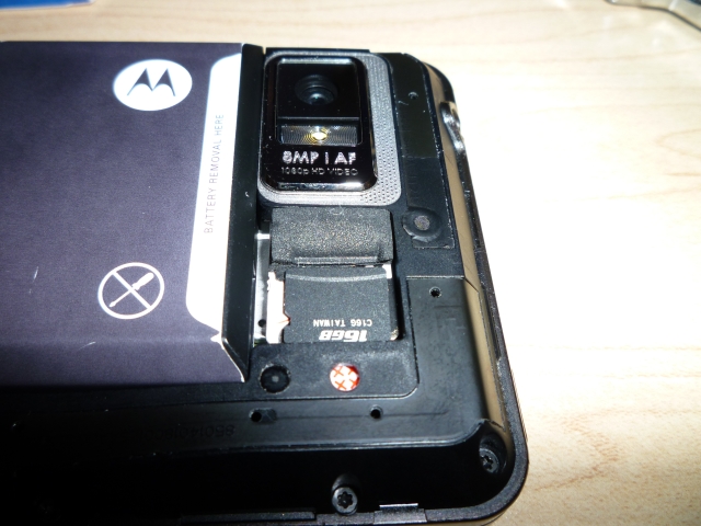

The user had a screwed SDCard after plugging it into the desk dock.
LIGHT BULB!!! Of course the SDCard can get dislodged when putting the phone in the dock - b/c the downward motion of the phone being inserted into the dock is the same downward motion (when turned sideways) that you use to remove he SDCard in the first place.
I note that in my reply in the thread, and then I outlined how I had freaked out hard core for 20 minutes one day when I thought my SDCard was dead - until I remembered to look at it physically to reseat it and saw it was simply dislodged.
So, I used some foam to make a little 'shim' to brace the car in the slot.
Pics:
I didn't take a pic of the battery cover, but if you look at it you'll see the little notch that is supposed to hold that SDCard in place - and how it is woefully inadequate.
This might be the first true across the board design flaw. I really don't see a difference between the extended battery cover and the stock one - both notches seem just a hair too short to actually keep the SDCard in place.
