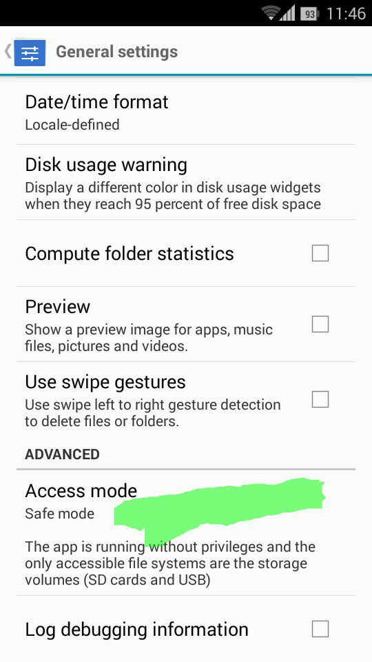

Just now im on 4.4.2 and in ES, the internal storage is named "sdcard" uploadfromtaptalk1397001826809.jpg
I doubt if this is useful lol but your data is in there somewhere. Once you find it, back it up and do a FULL factory reset and your file system will start to make sense again :thumbup:
In ES, try using the search function to find a file you know is in there. When you find it, long press the file, hit more, properties, and it should tell you the file path :thumbup:
