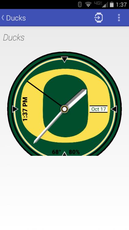

Here's a new one for my Droid brothers and sisters. I know the font isn't right but I like this font better :D
https://drive.google.com/file/d/0B50X2NRm3MbEOVNWa05WYmlBdEU/view?usp=sharing
Edit: Corrected hours.
