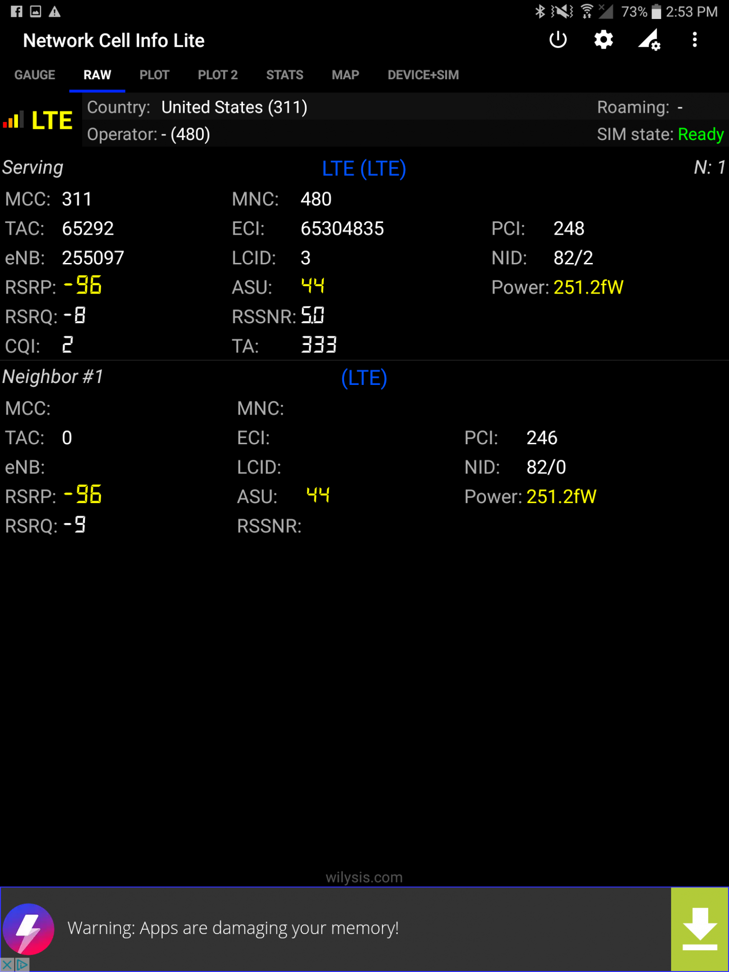

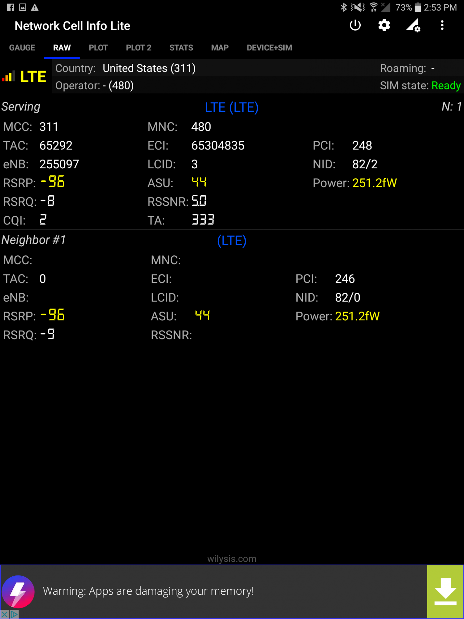

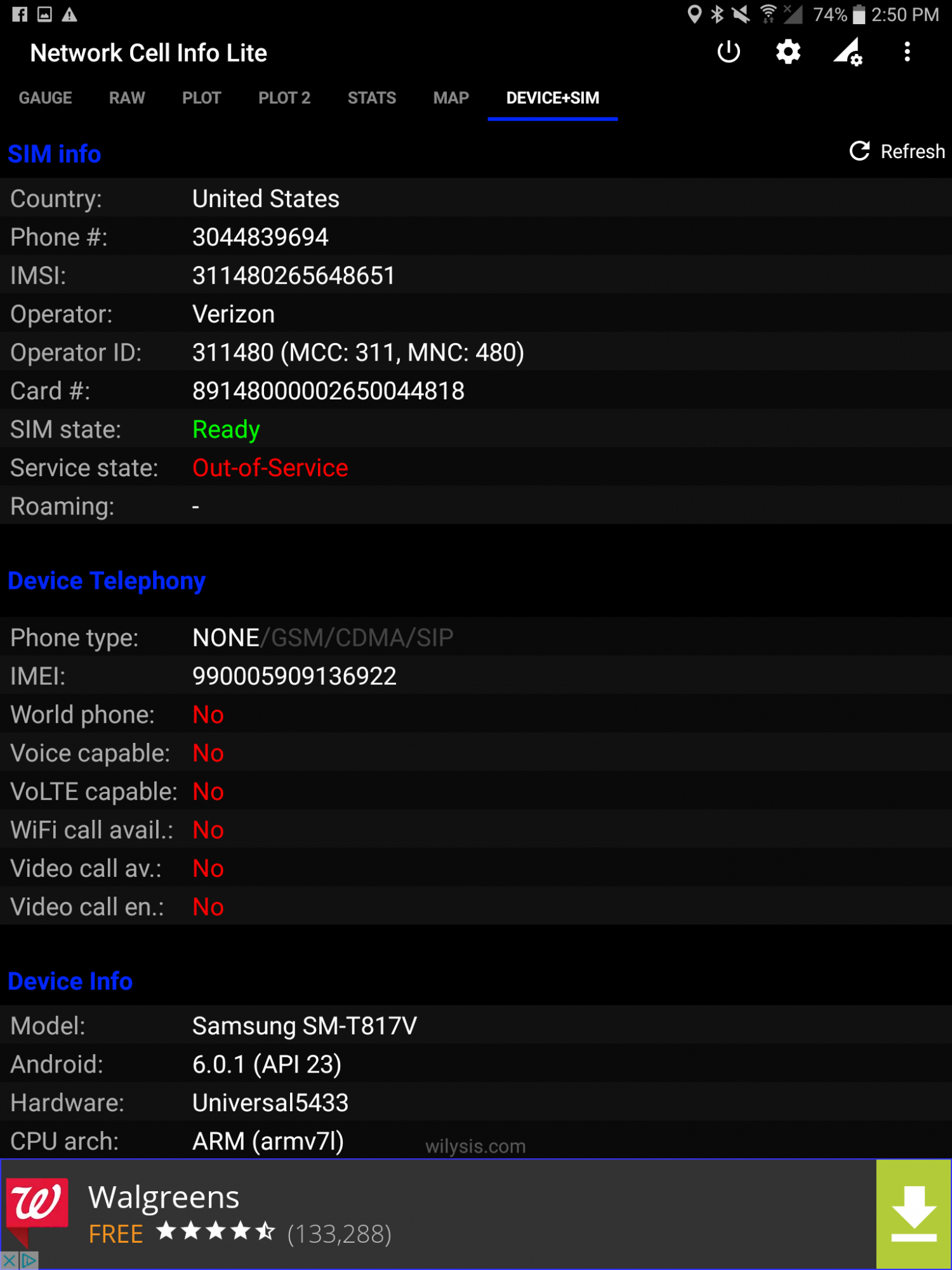

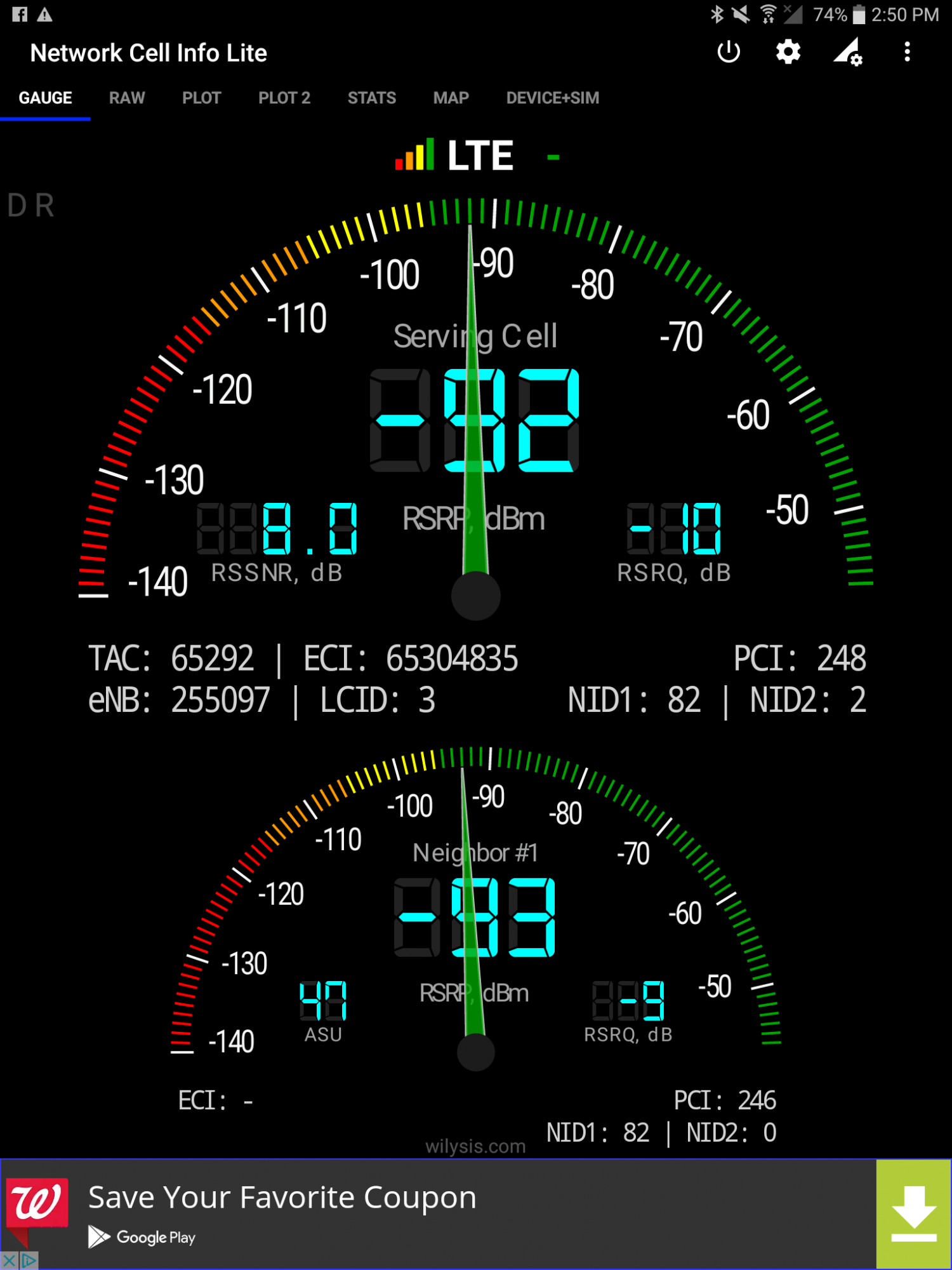

Screenshot_20161204-145036.png Screenshot_20161204-145009.png Screenshot_20161204-145306.png View attachment 112657 View attachment 112658 View attachment 112659 My booster has an outside antenna, and an antenna which is in the cabin. Doesn't have to be near a window. the rang for it is 5000 Sq feet. My husband has at&t galaxy s5 active and he gets 4good service with his phone. Like I said, my s7 edge pick it up and now my apple ipad pro does along with lg gpad 8.3. the Galaxy tablet s2 won't. and I have had all kinds of network readers 8nstalled on it. I'll take a screen shot and let you see the readingsView attachment 112653 . Verizon has no clue as to why, and samsung told me to take it to a best buy and have them refresh the firmware. Thats 80 miles from me. I can't find the firmware to flash it through Odin myself. And a factory reset did nothing.

But looking at your screen captures, I'm wondering what might be gong in with specifically with your Tab. In the first one (left most) there's a section titled 'Device Telephony' and under Phone Type it shows NONE. It should show up as CDMA (most phones are either CDMA or GSM) and at the very least show Voice capable as a Yes. While CDMA (Verizon) phones didn't utilize a SIM card, now with LTE so prevalent they often do. If there's a SIM card in your Tab 2 maybe it just needs to be re-seated:

Here is a screen shot with the Sim card in it..View attachment 112666

I'm out of ideas as to what could be the problem. Along with nothing being highlighted in the 'Phone type' category, that 'Service state' item should show as green 'In-Service', not red 'Out-of-Service'. It almost sounds as if your Tab 2 has no cellular service account tied to it, but since you've already reached out to Verizon that doesn't make sense either. Could Verizon send you a new SIM card? Maybe that one is bad, or is it a working card you just temporarily borrowed from one of your other devices.

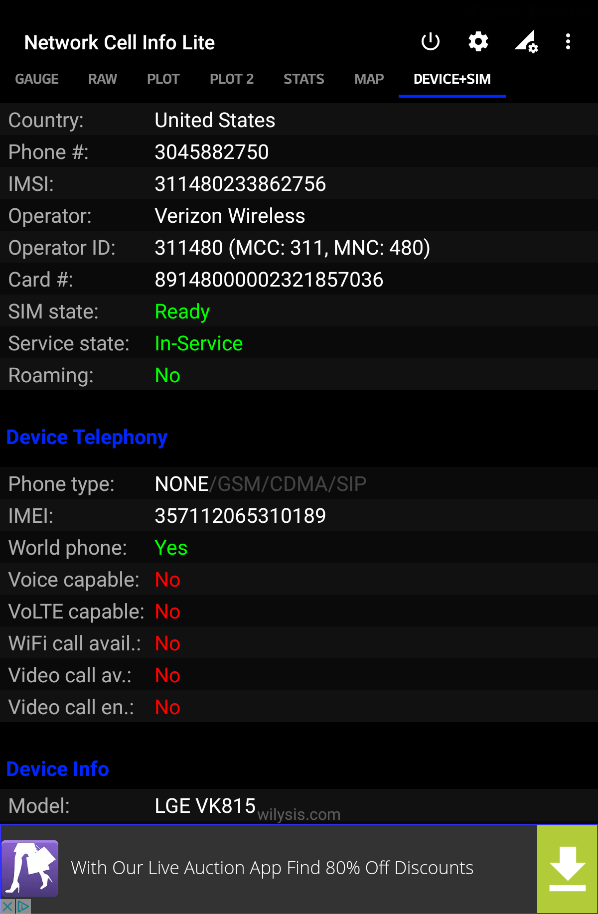

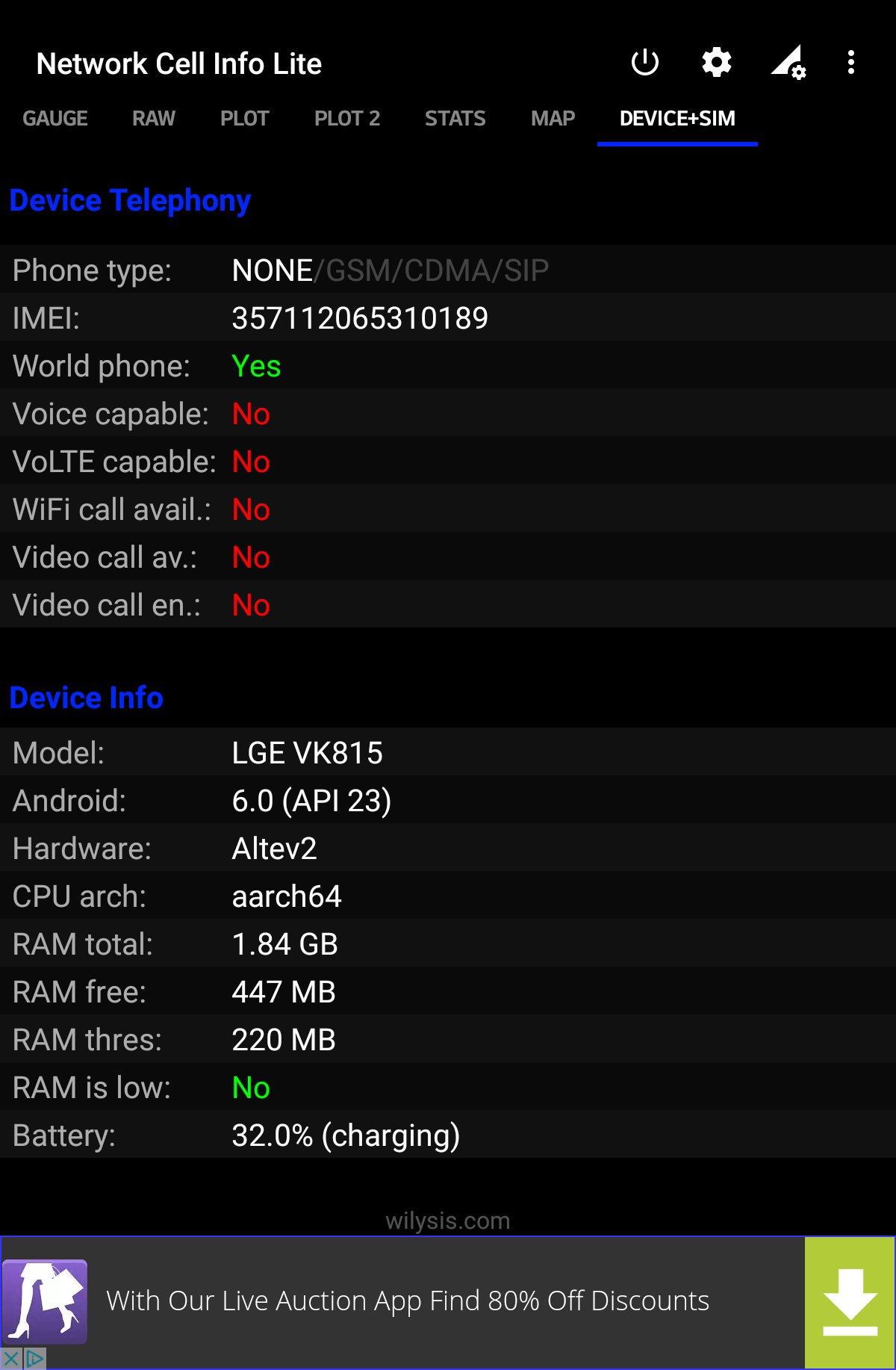

Here is what my LG tablet shows. There is no name in it either.
