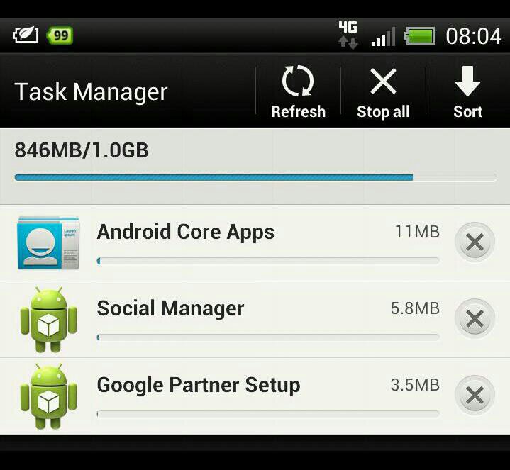

Not sure if this is significant, but I can't ser how these 3 processes are using ^80% of the processing power either :p
the task manager refers to RAM, not processing power. And android task managers (at least, on non-stock android) are notorious for not noting everything that is using RAM. For example, you'll never see anything related to sense show up, yet you know sense must be using RAM, especially if you're using the sense lock screen and sense launcher. However, if you use a third-party alternative like apex or nova, that will show up as using RAM)
I would hit refresh to see if more programs show up.
