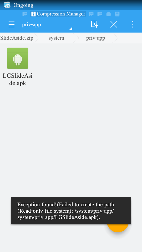

Sorry I'm getting this error what did I do wrong?

Made a quick video on the problem
I see your issue. You don't need to try to install it once it's in priv-app. Your permissions are wrong. Should be rw-r--r-- , like all the other apps in there. After that, wipe dalvik and cache and reboot and it ought to be good.
I thought you were having issues moving it.
