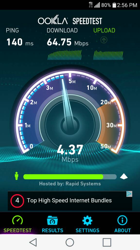

Alrighteee,here's my LTE Speedtest taken @ work just moments ago:

Here this its what i have been getting depending time, days and areas
I have notice that my Ping sometimes tale a bit longer

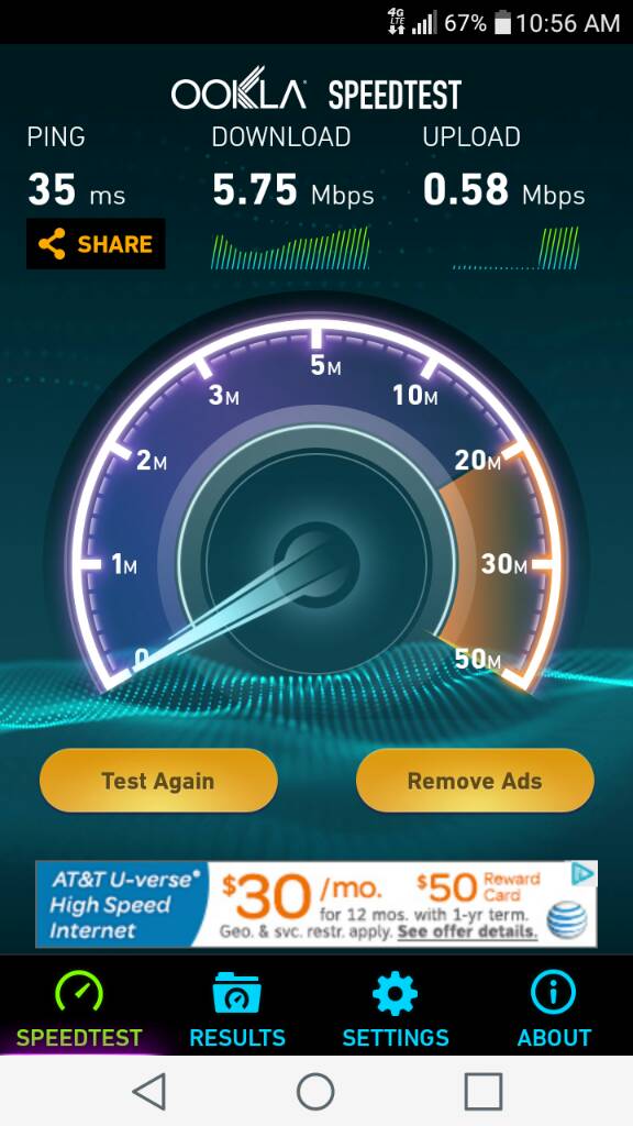

Here we go 1.96 on lte 12.30 on 4g last night. Today across the street from the tower 32.83 that's 0.2 miles from my house. Any ideas as to what is going on?.

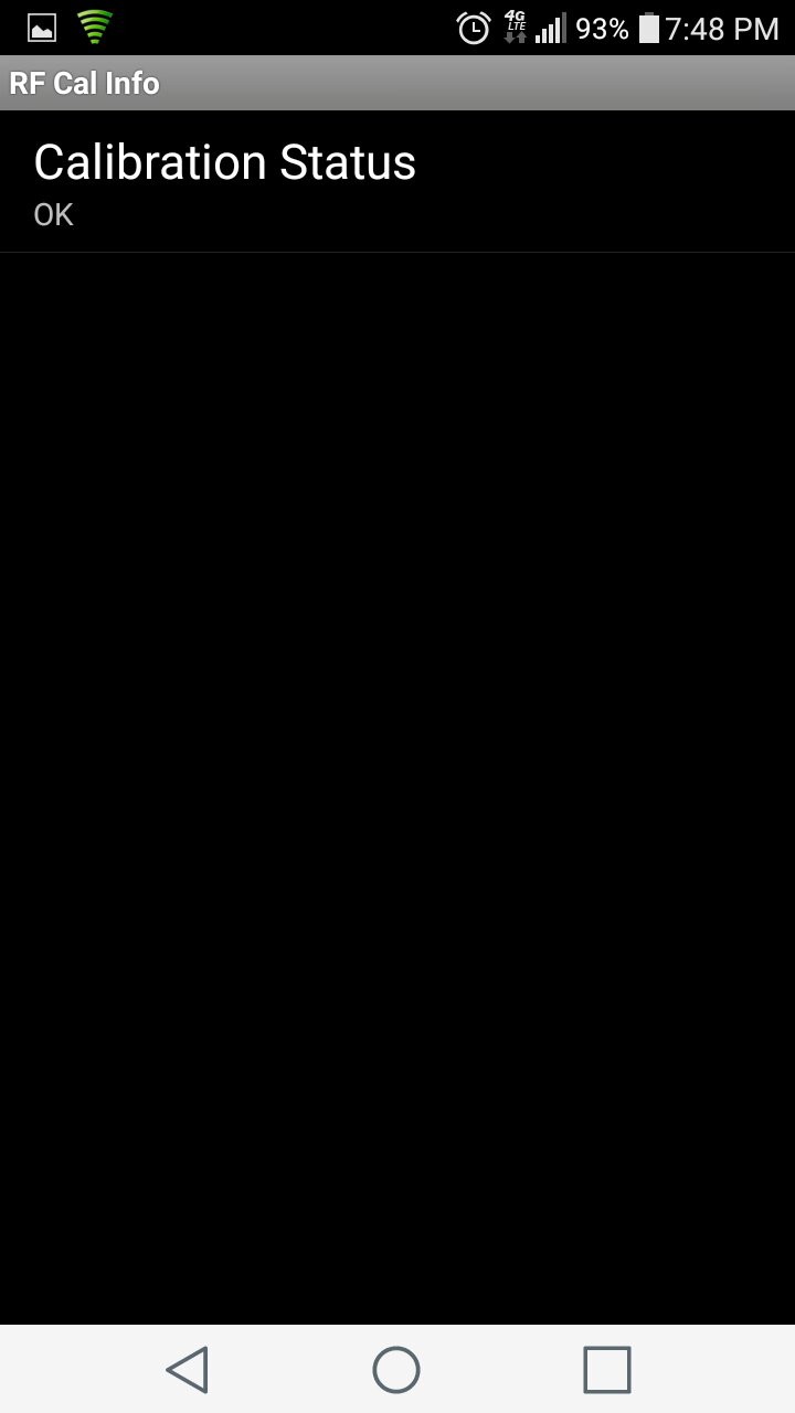

@t12b25 lets start like this...
*Are you rooted?
*Have you done any tweaks to build.prop?
If not
1*Go to dialer and dial 277634#*#
2* Go to ANT setting make. Sure it says calibration ok
3* Go to RECEIVE DIVERSITY .. Click on both ant.radios
4* PHONE WILL REBOOT...
"""" Now for this to work make sure you have control over your apps if its apps running notifications background ... Just turn them off dont be so lazy to check them manualy... LoL... Having to many apps runing their notifications in background will slow down you... ,""" Hopefully works... For you... Noi you are rooted let me knw.
*Are you rooted?
If not
No I'm not rooted and no tweaks. I'll give your instructions a try. What exactly does it do?. I'm by no means an expert especially not with lg phones. Thank you for your help.

@t12b25 Thank you for you honesty... that will set grounds...
Now what this does it to turn on radios...
http://www.researchgate.net/post/Wh..._the_Extended_DRX_defined_in_Release_12_or_13
Simple.. nothing to complicated...

It seems to have improved after following your instructions, you tell me. Thank you the phone seems to have new life thus far.

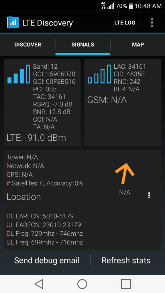

I have notice that @ least band 12 within my area its not to good @ gsm/wcdma/lte or LTE only... I did some few tweaks but so far in Tampa area band 4 its more strong..

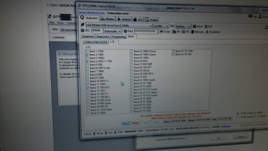

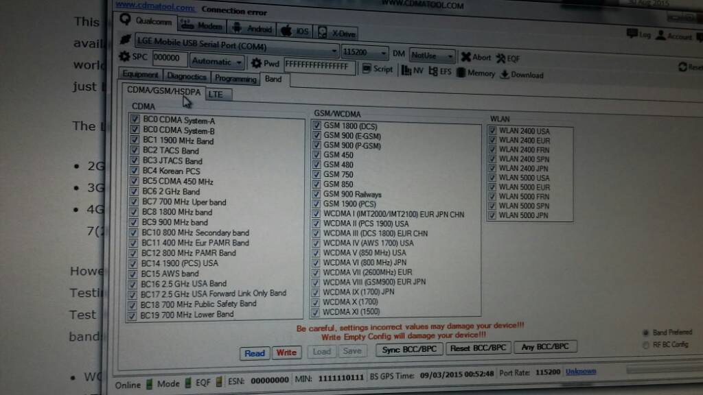

O have check bands n permissions and they are all working good I even opened bands...1.3.25.26.40. And opens successfully... Now they will only work if the defaults drops.. I knw that we are in conjunction with att for extended network. (not Roaming) so im gonna open low frequency one to see how they come out.

Well... After hrs of driving.. To keep y@ll updated... Tested other LTE bands..not good crappie signals... Band 12 for the central FL its still weak... @ least find out that we can open other bands (gsm,wcdma,lte) even internationals...explore more with the LTE bands from att we can make phone hook on those extended areas to catch some lte week but we can till connect data...
