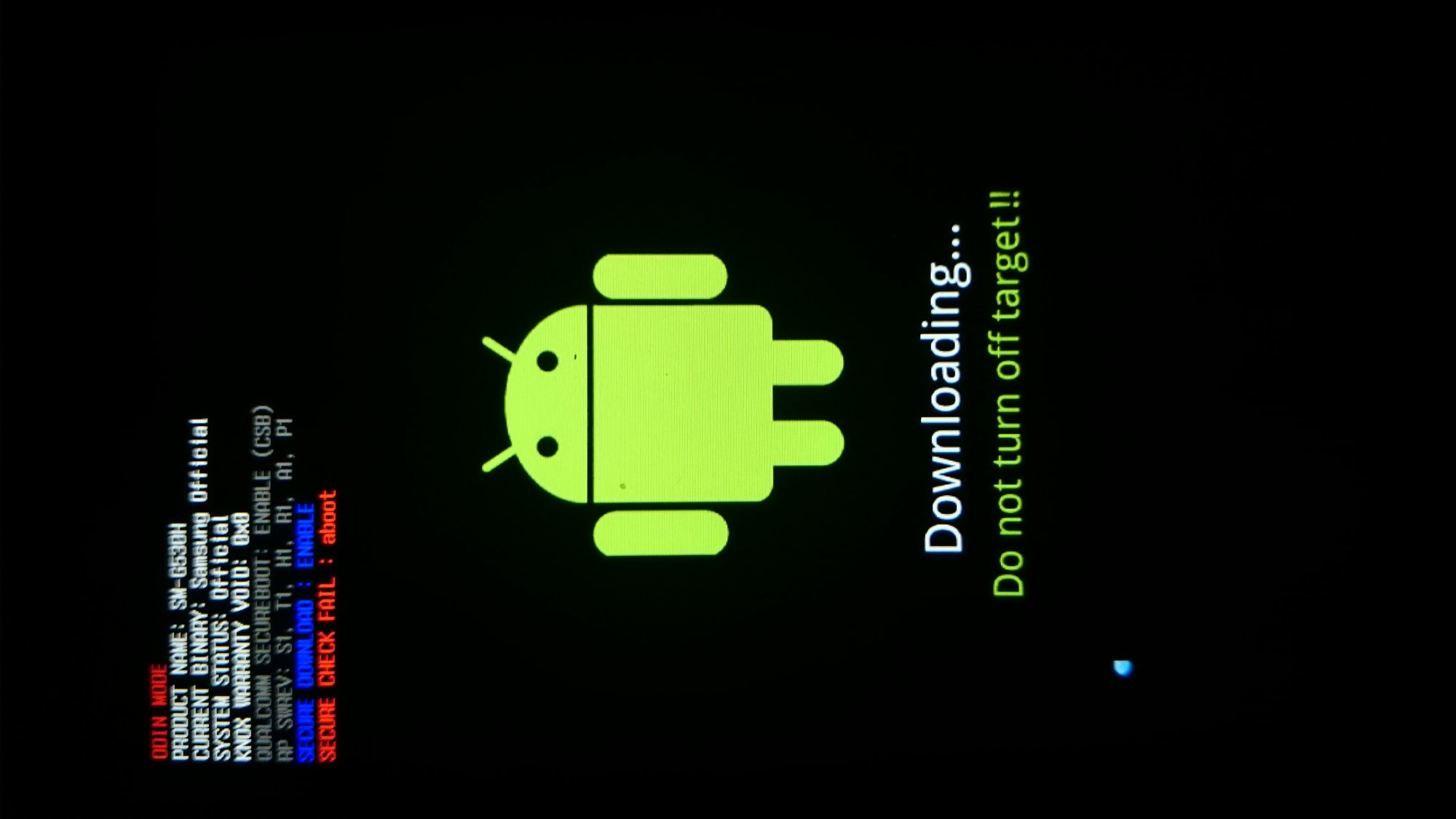

I've received a Galaxy grand prime SM-G530H without Android installed.
I want to install it , I've read in many forum about the way to do it but no one works.
I've used Kies last version downloaded from samsung website, I've installed the sub samsung device, I've used Odin 3.10 and 3.07, I've used too the original usb, different port and diferent cables, I've downloaded Russian, Mexican, Chilian, Moroccan, European Firmwares trying with kitkat 4.4.4 or lollipop 5.02 but all shows me the same issue as follow:

With international versions, the CSC and Product codes matter when selecting the correct firmware. Sometimes you can get by if you select the most current version for your Country and Carrier. 5.0.2 being most current. Fail( Auth) usually means wrong firmware.

It's what I think too, I live in mexico and I've tried with lollipop 5.0.2 MExico(telecel) but it doesn't work. I've seen in the phone package "American card Only" but the cellphone is unlocked. I've searched an us firmware but I didn't find it. In the manual user the model phone is "SM-G530H/DS" like this.

I have this :
Android system recovery <3e>
KTU84P.G530HXCU1AOE2
