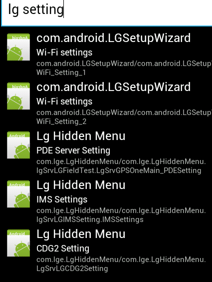

My lg esteem does not have hotspot option or if it does its disabled, I've used any cut before to access network settings, I've seen lg hidden menu before, could you explain how to get hotspot and how to use lg hidden menu please.

This attachment is what I see
Iunno, then. The best I can say is try all the hidden menus until you find the one that has Data Settings in it. They're two different phones, but they're both LG so they should be relatively similar internally
