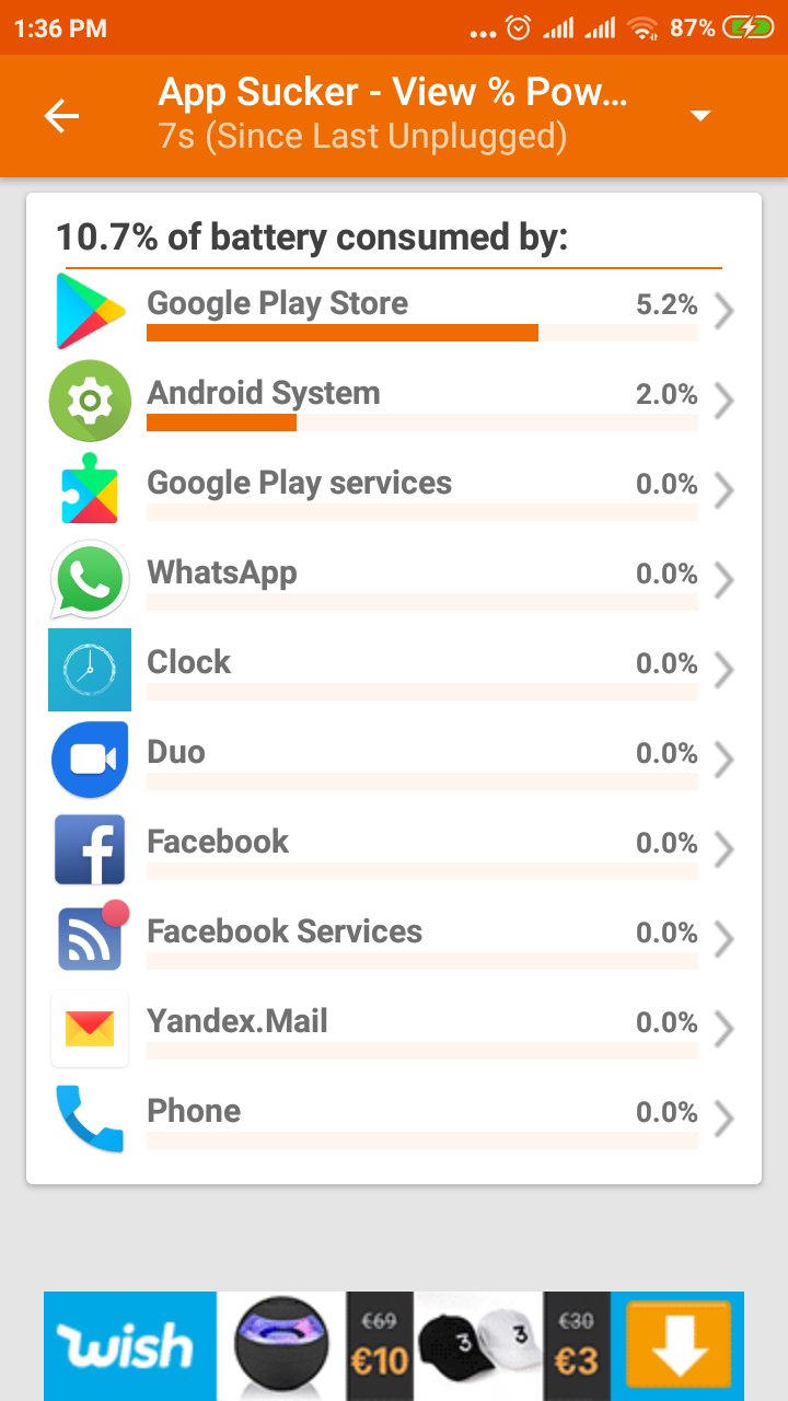

I ran GSAM with adb, and this is the result:

That seems a little excessive for the play store. Do you have any pending updates?
Yes, I have 8 updates pending, but the play store is not open when I hold the button to show opened apps.
Doesn't matter, the play store has to always have services running to authenticate apps, so it will show as the the play store app in your running apps and power usage. You might have an update that's continually trying to apply or download. My advice is to update those apps, then reboot your phone to see if it makes a difference.
After applying the updates and rebooting the battery lasts longer now. Initially I thought it was malware causing this, but now I don't think so. I have ESET(the paid version) installed, as well as Malwarebytes and none of them had found malware.
