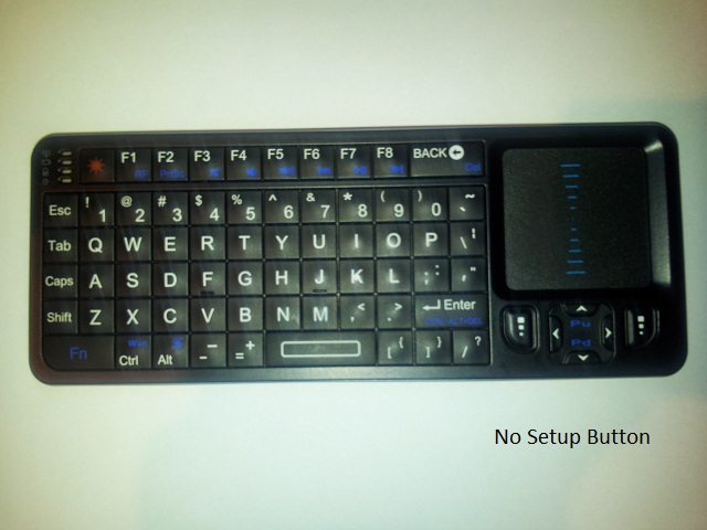

Hi all,
I have and ider A10 with GB 2.3.4 " NOT ROOTED" and I bought a nice RF wireless mouse/keyb from here...
Deal Extreme Ritek Rii-mini-i6 wireless 2.4Ghz
Now, all works perfect except 2 main keys..
MENU.. and SETUP.. vital for android operation.. isn't it?
well, i found in some other post that only we can have remapped keyb on rooted devices.. IS NOT MY CASE (yet) but there are good friends of mine working on it :-)
now... in the meantime, who has the tweek/solution to remap those keys in this android box and with wireless mouse/kybrd?
/// SOLVED /// Finaly ROOTED and using Button Savior (paid version) + IR learning function for MENU and PWR ON/OFF..
(se details below)
Many txs!

Hi:
definitively my Rii mini6 works perfectly.
The only drawback I've found is the button mappings for Android. They (Riitek) has not been able to think in android on developments days..
I encourage them to provide me a software fix and they told me it's gonna be too complicated.. (so, Bull##$$t).
I didnt use the IR back on the RC, but RF works like a charm at 15 mtrs.
cheers!

Finally the Rii-mini-i6 keyboard mouse and remote 3-in-1 arrived. I totally agree with you Walteroa, it works really well. My usage range is > 8 metres. I used the remote to learn the factory remote control for the player, utilising 2 sets of learning, i can learn the Home, Menu, Back, Arrows (directional button) and OK. Very very happy with the Rii-mini-i6.
One downside, you still need an Air Mouse to play fruit ninja on your telly =) Too slow with touchpad mouse =) So are you a gamer or movie viewer? Choose your mouse wisely
how did u learn the setup button to the back buttons of the new gadget from the original RC?
could u write a simple step by step guide?
(i've lost my original manual...)

I have a different solution
This app (button savior root) https://play.google.com/store/apps/details?id=com.smart.swkey&feature=search_result
will activate buttons on the screen by swiping your mouse (or air mouse)
the important buttons such as home,menu,back,vol+,vol-, off are there on the screen and you can use them instead the broken ones on your remote
Just a thought
Since I've installed this app I no longer use any of my remotes (fv-1 or R-Box)
