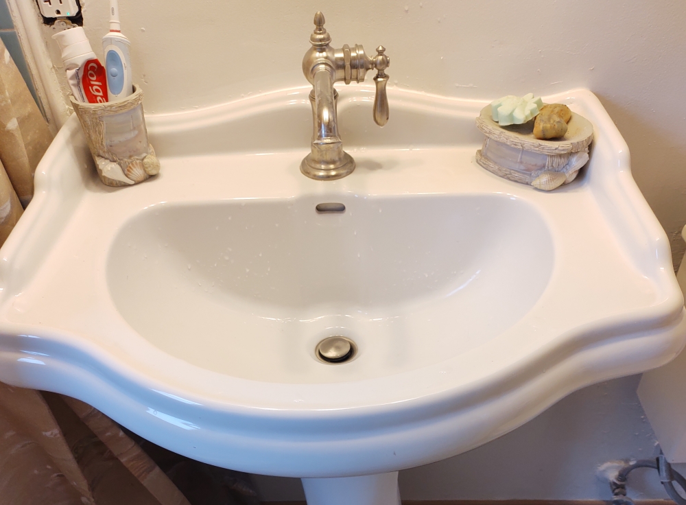

When my new pedestal sink was installed, I asked the contractor how to plug the drain, since there is no up/down plunger thing like on all my previous bathroom sinks. He demonstrated, and then I did what he did, and it worked fine, i.e., press down and turn the stopper to plug the drain, press and turn the other way to unplug it.
But today....it's stuck! No amount of pressing and turning is getting it to open back up. Is there a trick to it? :o
Here it is (when it's not plugged!):
The drop rod (lift rod) has likely detached from the stopper rod. The former is what you pull/push on when you grab that little brass knob. Does the rod come up freely? Or does it stop at some point?
If the former it is detached. But if it stops coming up when you lift it, then it’s probably that the stopper rod has let the stopper slip past it. So it’s just moving up and down in the drain without engaging the stopper.
You can use the tip of a knife to get under the stopper and lift it enough you can grab it with your fingers and lift it out. After that you will be able to look down the drain and see the stopper rod. Move the brass knob up/down and you should be able to see it move.

I'm sorry, dear, but I'm totally lost. :o What rod? There is no rod--the only thing I touch to open/close the sink stopper is the stopper itself. As described above, push and turn one way to close, push and turn the other way to open.

I may wait for my contractor (who's coming this week to finish up some projects), because my eyesight has gotten so bad that I don't trust myself to fiddle with it and NOT damage it!
I'm not familiar with your new fancy drain stopper Moody. I found something that seems quite similar on the net.... however, it is a push down to seal and push again to release. There is no turning at all. Perhaps the turning has somewhat managed to cause the stopper to be somewhat askew in the drain. Try pushing down and turning the opposite direction you've been trying. It might free up the mechanism so that it can freely pop back up. I wish I had more to offer but the drain stopper is new to me.

It sounds like the plunger/stopper has broken since it won’t release. It’s good that your contractor is stopping by anyway and hopefully he can resolve it simply.
If you had a small suction cup you could try and use that to lift the plunger/stopper. I have a couple I use to open mobile devices that would work; perhaps you have one as well?

They normally only need pushing to operate, the turning motion should allow for removal of the stopper.
I have worked in the apartment maintenance industry for many years and this is my least favorite stopper of all of them.
It is prone to getting stuck closed and requires changing out after the push function goes south.
If you can get it to come out check that it is not clogged up with hair, that is a very common issue.

Update: I bailed out the water (as seen in that video) and dried everything very well, then let it sit and air dry some more. The next morning, my helper pushed down on the stopper, and guess what? It's fixed! :D
Thanks everyone for the help and suggestions. *I* can't really explain how this method 'fixed' it, and I don't know if it will work again or for someone else, only that it's fixed now and all's well again!
