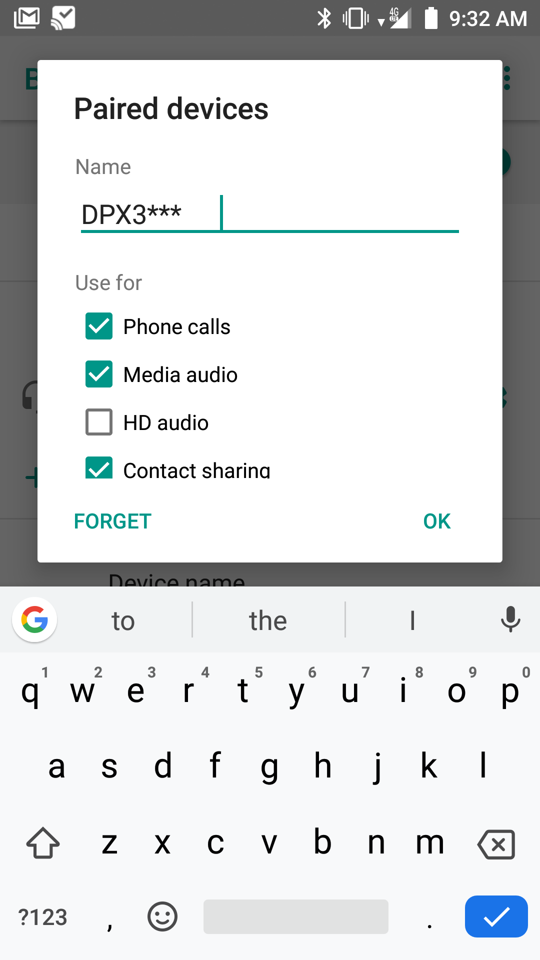

Thanks for the information-I was not aware of what version of Bluetooth the Sonim had until now. I went back and decided to play with the settings some more and found this screen (screenshot attached)-both the media box and the HD audio box were checked. I unchecked and rechecked media which did nothing, but when I unchecked HD audio I got audio over my truck stereo. I am guessing that the HD audio is a feature of 5.0 that is not backward compatible to/supported by 3.0:
Yes, that's correct. Although I thought Bluetooth was supposed handshake and deal with different version compatibility itself, like NOT trying to send HD audio to a device that can't decode and play it. The Media Audio is most likely SBC(Sub Band Codec) that all BT audio devices support, the A2DP profile, but doesn't necessarily give the best SQ because it's a lossy codec. Some BT devices support AAC, that is apparently better SQ, but is still a lossy codec.
