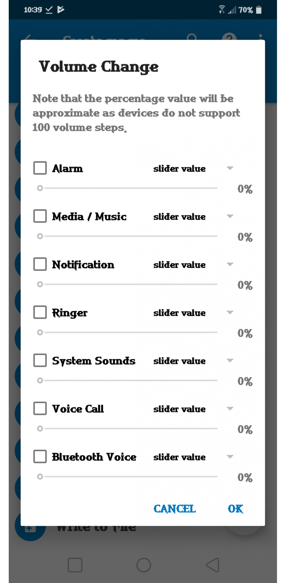

MacroDroid lists 7 volume controls.

MacroDroid can't "Lock" the volumes, but it can preset them for whatever conditions that you like.
Thanks, but I have an app that can preset them. My problem is that somehow I lower the volumes accidentally. Then I miss something important.
