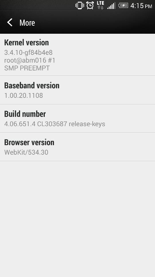

My biggest issue right now is that I can't get adb to recognize my device. It says "list of devices attached" but no S/N. I have a working (rooted) phone (Bad Boyz ROM 4.4.2 deodexed) but the Mods that O.M.J. lists do not show up on my phone... though the ROM & Custom Kernel show to be installed. Do I need to flash their modified Firmware as well as just the ROM? I downloaded and installed ROM using my phone SD card via CWM.
Much thanks to you too. You've been tons of help so far.
What's the best way to give you better details? Screenshot my phone Info? I have Win7 x64, Sdk tools, minimum adb & fastboot installed in system, with Path variables set to that location.
Here's my phone info(?)
