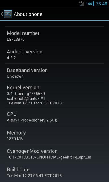

CM10.1 is here for the LS970, aka the Sprint LG Optimus G.[/PHP]
This is a source build rom, which includes all the latest changes from cm and codefirex with respect to kernel.
While the efs issues have not been solved, our custom ril class seems to have helped. The rom by default backups up on first flash to /sdcard/EFS_BACKUPS/ because I know some of you won't make efs backups before flashing.
