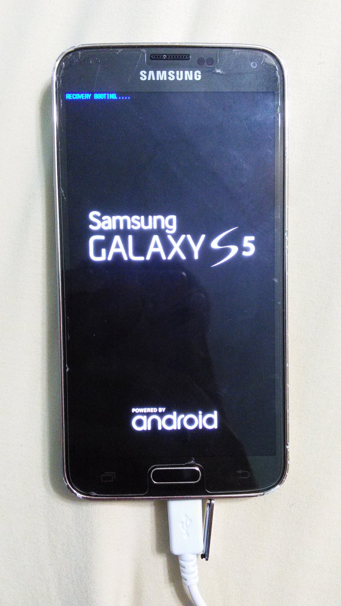

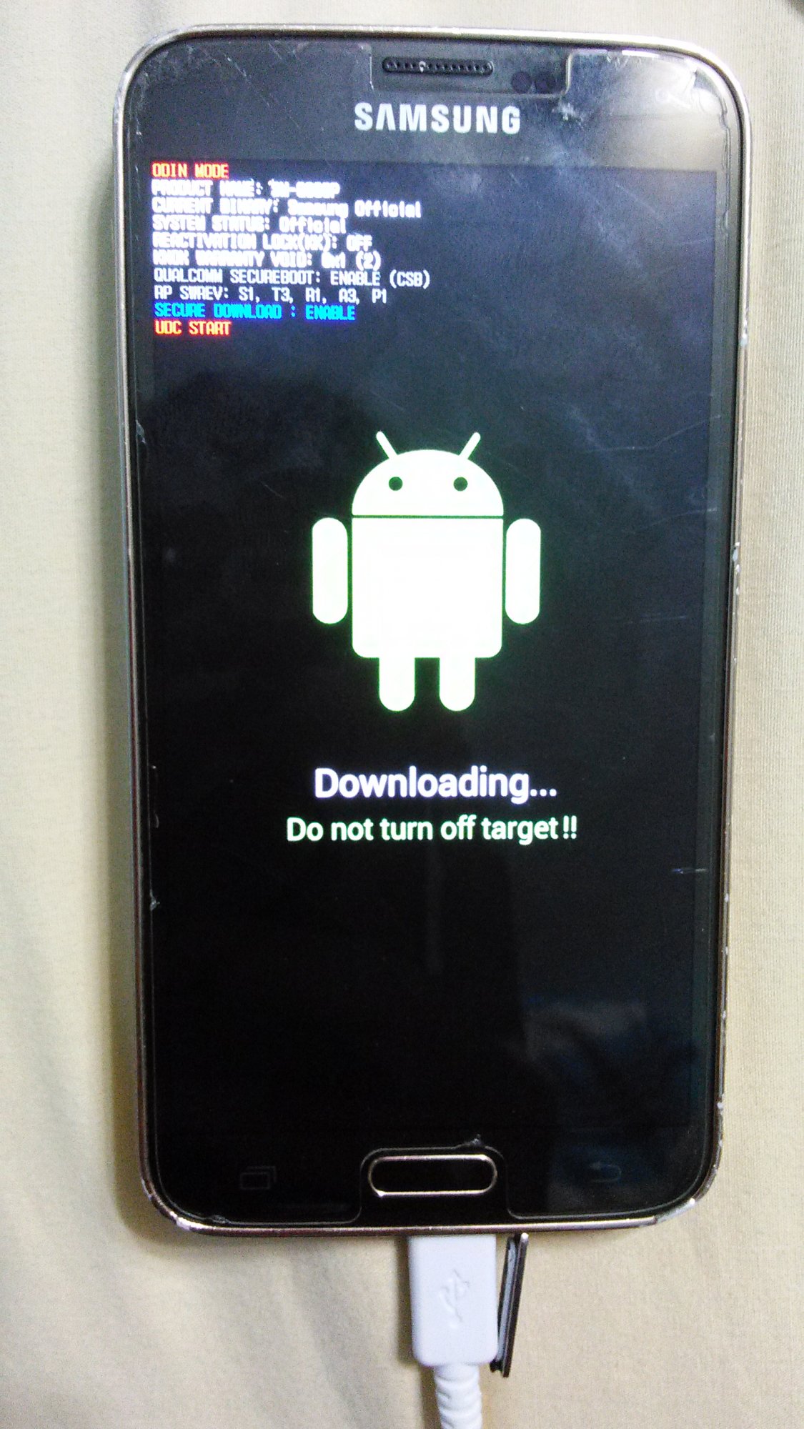

Need help. My phone keeps getting stuck on recovery booting (blue text). I can get into download mode. I tried flashing stock tar file thru odin and nothing. I got the tar file from sammobile.
I also tried going into download mode and restarting from there but it keeps going back to recovery booting. At the recovery booting stage it reboots after a couple seconds than goes back to recovery booting.
The phone model I have is the Sprint G900P.
You appear to have a previously rooted Sprint carrier branded, minority variant, model G900P. If the phone was previously rooted, did you correctly remove the root prior to flashing the stock Samsung firmware?
Also, are you flashing the correct firmware for your models Product code as there are 4 different versions of each Sprint firmware?

Sorry, I just saw this, but idk if it makes a difference. When looking at the download mode it says reactivation lock (KK) off. Does the kk mean kitkat? If it does shouldn't i be flashing kk 4.4.4?
I tried flashing the version you gave me, but it didn't do anything. It keeps getting stuck on the recovery booting, after the firmware flashes. :(
As per post #2... Did you unroot your phone properly, (which method did you root with originally?), and are you sure that you are flashing the correct firmware? As per post #8, did you wipe the cache partition or FDR your phone after flashing?
I honestly don't remember which method I used to root and Unroot. I am flashing the correct firmware. It's the one you give me. How do I wipe cache partition or FDR? After flashing the firmware the phone restarts and goes back to recovery booting.
It won't go into recovery mode. After flashing the phone. I hold the the 3 buttons simultaneously. This green line comes across the device and it goes back into recovery booting.
