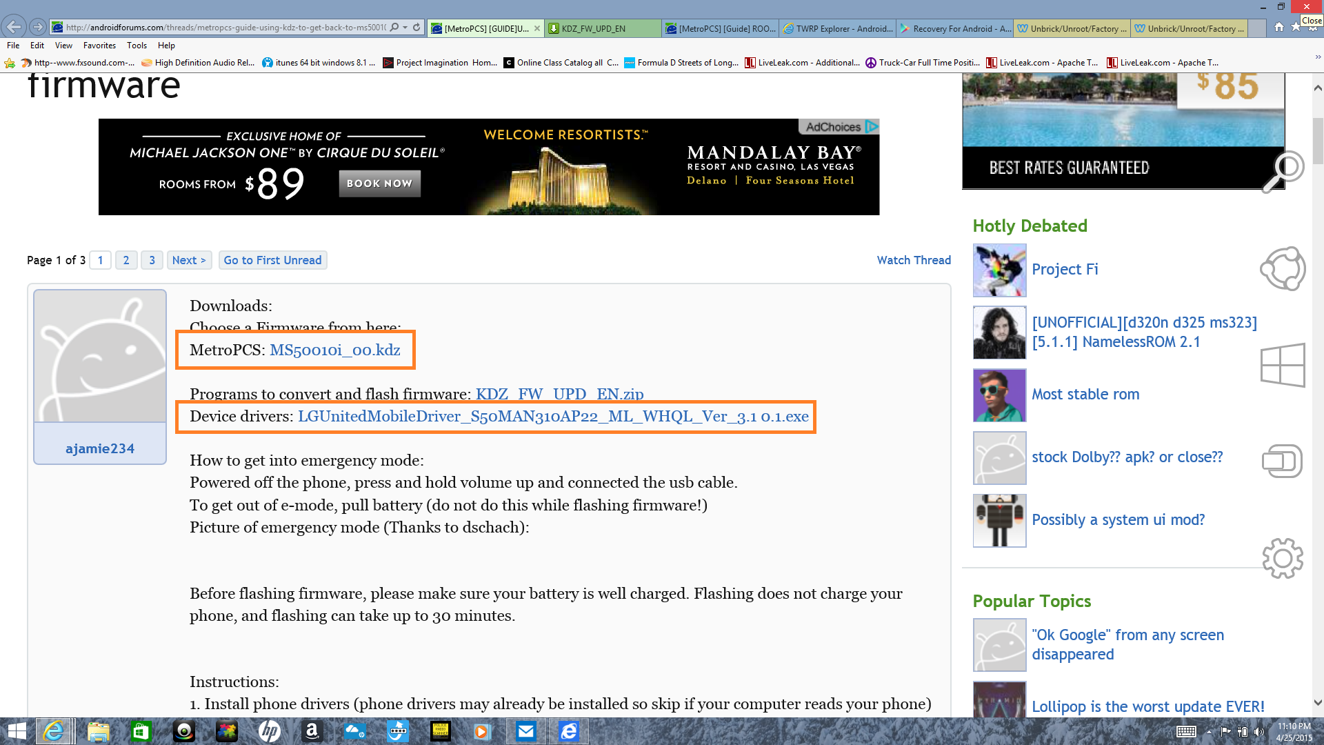

View attachment 86396 Hey the links I hi-lighted come up as not found and I think it was like 404 or something... I have a different link I wanted as you if you think is ok or not.. it's not the 500 10, it's 12.. ??

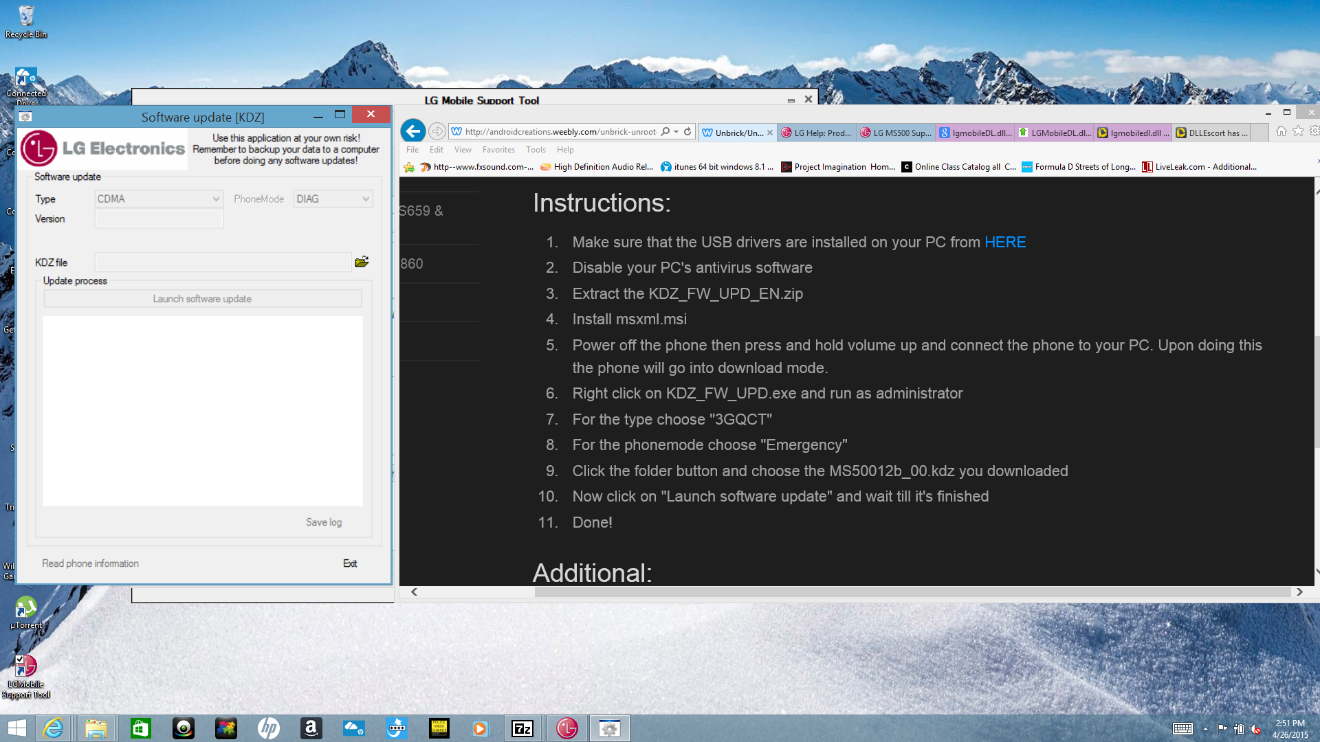

http://androidcreations.weebly.com/unbrick-unroot-factory-restore-ms500.html
Yeah the page you found is safe, that is GameTheory's site he's a developer on here if you didn't know. Firmware 12b is actually the one you want anyway. Your f6 is the metropcs version right? If it's tmobile the procedure is the same but different firmware file is needed.
Try doing the steps in this order.
1 2 3 4 6 7 8 9 5 10
You can also try them in this order.
1 2 3 4 6 9 7 8 5 10
Steps 5 through 9 can be tried in any order.
The main thing is just don't press "launch software update" until you have done all the other steps.
I hope this helps.
