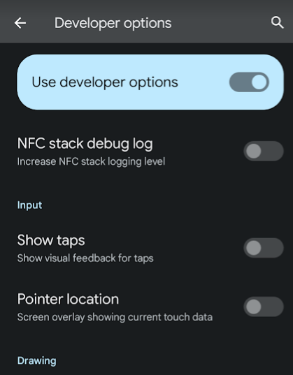

Hi, I have samsung a52s 5G (SM-A528B/DS) with android 12 oneui 4.1
I have a colored circle that appears wherever I touch the screen (any screen!)
I have enabled the developer options , and am told to look for 'input' option..
BUT I cannot see this anywhere!!!!
Is it the shop taps option?
Did it started without developer options or without showing a white circle?
I turn mine on, because I am a horrible typist :)
Thanks for replies... I see 'taps' and pointer location, but they are both off..
it started happening before I enabled developer options, that is rather hidden... :O
switch on 'taps' I get a white dot, as well as a blue transparent circle...
'pointer location' works as it should do...
