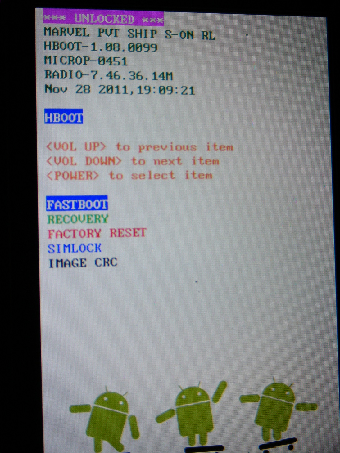

Hi all, tried to install Cyanogenmod7 on HTC Wildfire S Virgin Mobile Canada after unlocking with HTCDev, installed CWM 5.0.2.8.
Rooted with Revolutionary and got the ROOTED successful....
Now I have HTC screen and I can also go into HBOOT and ClockWorkMod recovery .
I had Android 2.3.3 with Sense 2.1, Software # 1.36.666.5.
HBOOT says ***UNLOCKED*** S-ON ( please refer to attached image)
Don't worry--this phone is saveable. The white screen is a good thing to see. Options:
1. Did you backup your stock ROM in CWM Recovery before flashing CM7? If so, you can do a factory reset, wipe all cache including dalvik and restore your backed-up ROM. But that's no fun, because you really wanted to see CM7, right? So...
2. Did you do a factory reset and wipe all cache including dalvik before flashing CM7? If not, go back into CWM Recovery and do that now, then reboot the device. The ROM might work. If not, try re-downloading and flashing from this link:

3. If still no go, try flashing another ROM for Marvel since from the HBOOT picture, that's what you've got.
