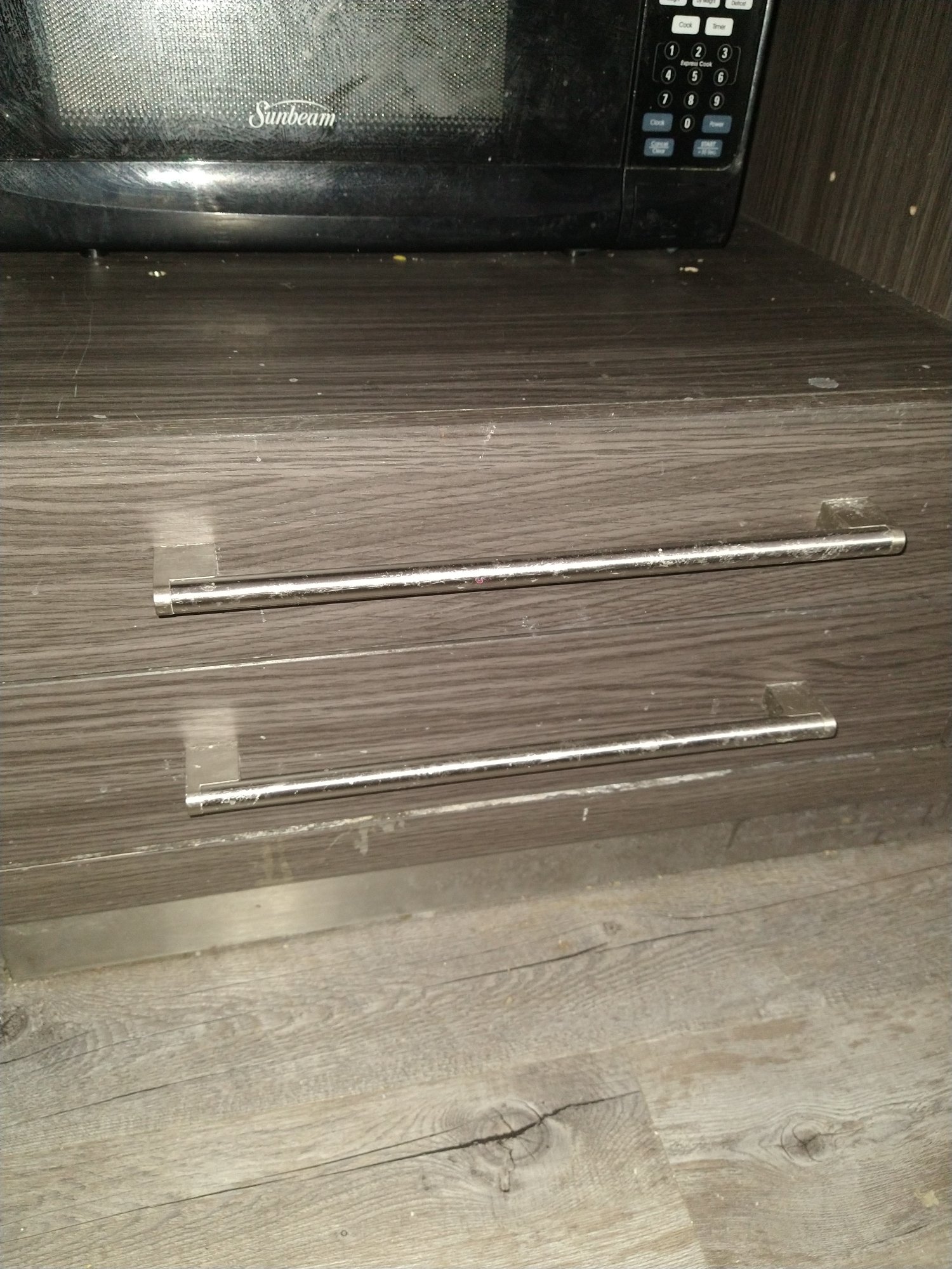

The drawer is not actually stuck, and it appears to be nonremovable. The problem is at least one object trapped behind it (the lower drawer). There's not much room in front of the two drawers. I've taken another photo which I hope will be more explanatory.

Actually, it's a microwave oven. It probably doesn't weigh that much. I'm not sure how to unplug it, though. The outlets are really weird and not many of them.

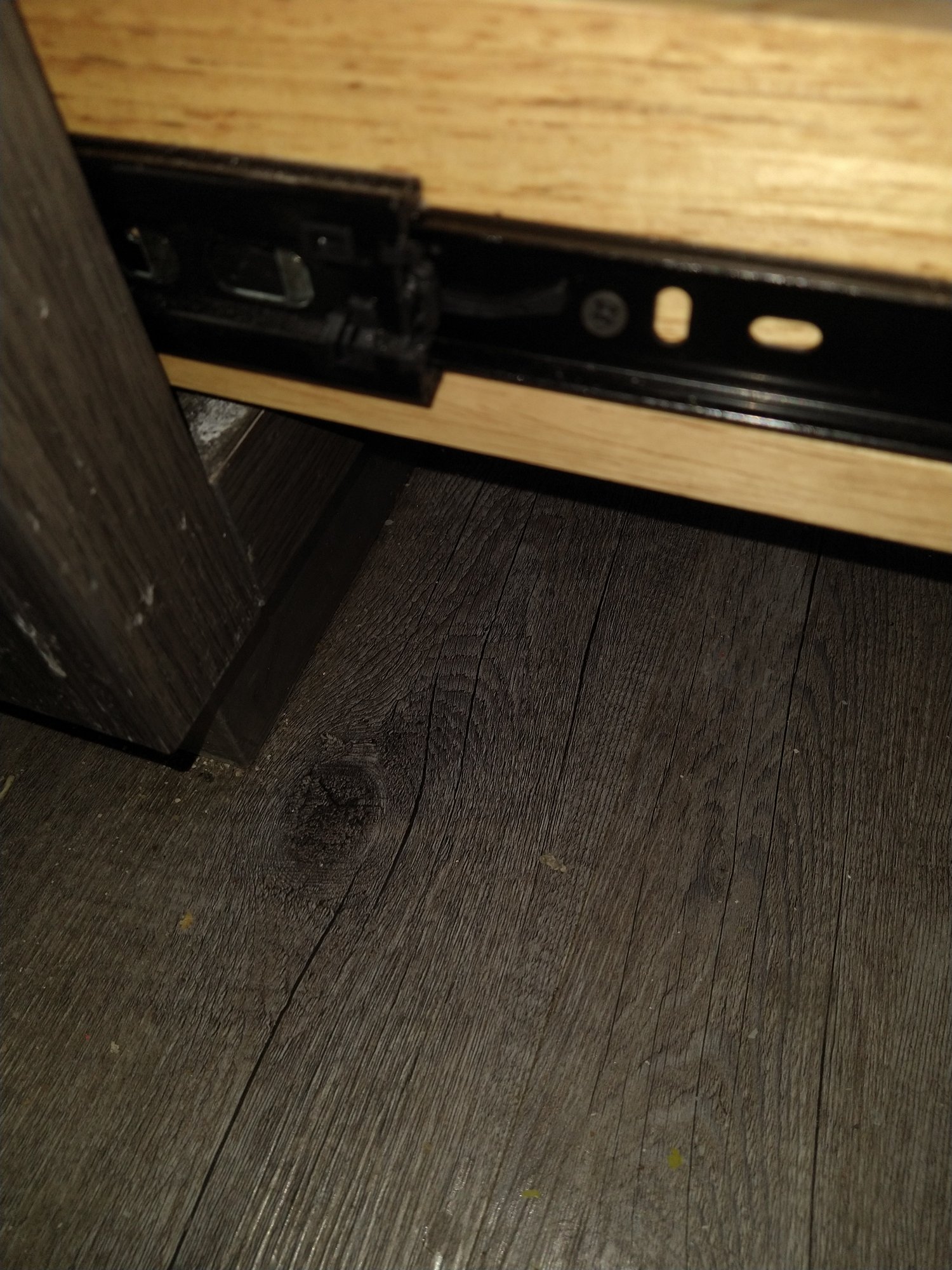

They can be removed completely from the cabinet. I need a picture of the side of the drawer when it's open so that I can tell you how to release the stop so it can be removed. Once removed the item / items should be easily removed.
Okay, I'm coming in late, but it may come down to you removing everything off the unit, pull it from the wall and if you can't access the drawers from the back, then try laying the unit on the backside. This will allow the loose items in the cabinet to shift to the back, and perhaps you will be able to pull the drawer out some and free it.
At the intersection where one part of the slide goes into the other you should see a portion that can be depressed. Both sides will have to be depressed at the same time and then the drawer should slide on out. Your picture isn't clear enough to see the exact release but it exists.
It looks to me like you have the little plastic fingers sticking out between the two rails. Push one down and the other up to remove the drawer. You will have to figure out which one goes up and which one goes down, but that's pretty simple.
