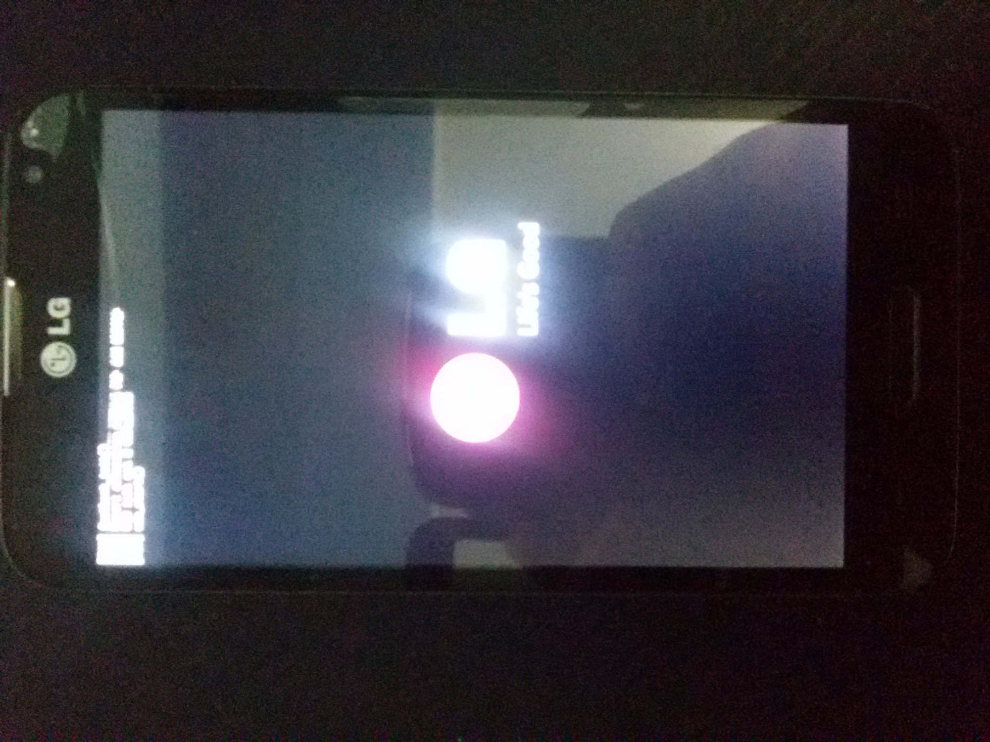

I can enter factory reset and when i enter and make factory reset it does nothing just says factory reset processing ... and nothing also i can enter download mode
but i dont now what to do or how to exit fastboot mode
also i cant connect it with my pc
i preesed bootloader on twrp recovery by mistake and it got into fastboot mode and i cant get out and use my phone

I had this same problem....I got out of it and able to get into download mode by using the LAF Multitool and then got someones original laf.img and replaced mine with it....then used the Z option on Laf Multitool, reboot and use key combo to get back to download mode. I added the laf.img to my post for you...hope it helps.
